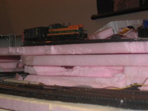

extruded styrofoam is the pink stuff you've seen all along in my layout. It can also come in blue and green
Its comes in 4' x 8' sheets, from 1/2" to 2" thick

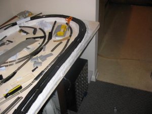

well, after some rearranging the train is at least operational, though some roadbed needs to dtill be placed!
Here it is against the wall now
