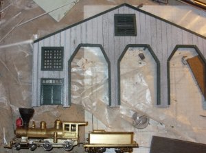

SML batten & HOn3 4-4-0.jpg Battens!
It didn't rain today, and they are calling for rain for the rest of the week, so I figured if I was going to paint some battens for the engine shops any time soon, it would be today.
So I painted some battens until I ran out of white spray paint ( need some dark grey as well. once I had some battens painted I had to cut some to fit and glue them down (still don't have all the trim on the last wall. ) I am pleased with the look, the subtle difference in the paint helps the tiny battens be visible without looking too oversize.
The locomotive is a HON3 FED 4-4-0, which is getting re wired to make it operable in advance of getting a paint job. later on it will get a Loco-Doc conversion motor , which, with the rewiring and extra electrical pick ups will make it a fine running engine. Out of the box there was no locomotive pick up on a tender drive locomotive; all the pick up was on the tender, so torque related tender rock would interrupt the power to the motor, making them horrible performers . They cost $38.00 new if I had known to fix the pick up problem I'd have bought several each of the 4-4-0 and 2-6-0. as it is I have one of each now.

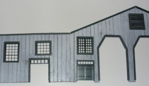

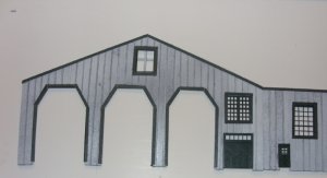

SMLBTN dtl.jpg mr btns n Nth wl.jpg Slow progress on Battens
Being busy, I haven't made lots of progress. I have altered my technique some which speeds up the process considerably. After spearing the piece of batten (already cut to fit) I drag it through a spot of tachy glue rather than applying the glue to the back of the batten with a pin head. I get more glue on t faster that way. I then rub the back if the batten on some way paper to spread the glue around some; use my fingers to wipe off some of the excess on the sides, After the batten is in place, if any glue oozes out i use the point of an exacto knife , or w wooden toothpick to clean it up it up.
Starting with the battens on this north wall, I kind of got ahead of myself, as I don't have all of the green trim, or the louvers done on the south wall yet, but that is not unusual for me.
When I have all of the battens on this south wall, I will make tracings of the door openings (marking them so I know which is which.) Then I can set the wall up on the layout for a wile, to be returned to the workbench once I have the doors and hinges built .
Once this wall is off the work bench there will be three things to work on next ; battens for the east wall, trim and battens for the south wall, and doors and hinges.
I'm not even thinking about a roof yet, installation of the walls doors hinges, and the painting of and placement of interior details will come first. I still have sone engineering work to do concerning the attachment of the walls to the post and beam frame. Questions abound; Do I want to make all of the walls removable? or just one?
Once the walls are in I may have to revisit the Harlow enginehouses, and see if there are upgrades I can make to them. and at Stateline (dual gauge) there is no engine house yet, and the turntable isn't even in place at the end of the line in Gegokayoosa, up on the narrow gauge. As I have revisited my planning up there I am considering adding to the insanity (Gegokayoosa is on a shelf, hanging from the 45 degree angled ceiling) an putting in another duck under ( walk under if you are less than six feet tall), and putting in a tight radius return loop over the storage cabinet on the North wall of the rr room.)
It is time for me to go out into the woods and get some firewood while the sun shines. more later.

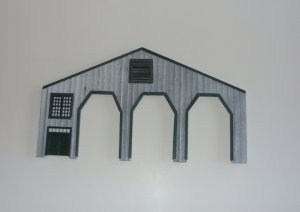

SML bttns n E wl.jpg I'm starting to put battens on the east wall. I used some of the green trim wood to make little high light windows over the freight door, trying to mimic the grant line door castings on the North and South wall, and kiked the way I pulled it off.
The battens go faster on this wall as all the cuts are ninety degrees

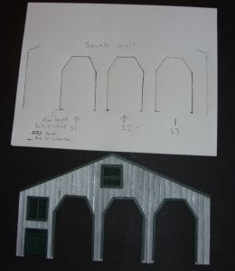

SML dr tmplt.jpg templates for the doors
I made templates for the doors on the south wall.
the marks at the bottom of the door are @ floor level the code 70 rails will stick up .070 abpbe that, and I'll have to leave a little more for clearance.

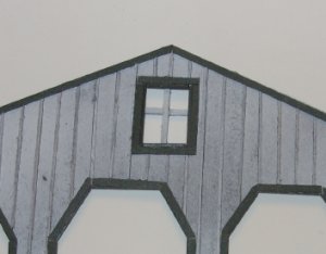

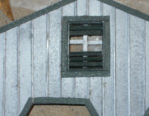

SML sth wl rdy fr lvrs.jpg SML south wall  battens!.jpg battens on last wall
I got the battens on the south wall! The west wall touches the wall of the RR room without room for the trim or battens.
I have the hole for the louvers framed in. I do this the same way I framed a window hole with trim on the inside of the opening all the way around, and then trim all the way around the outside.
Next I need to cut louvers to fit, and hope I have enough of the green material to get all the louvers and the little lights over the freight door on the west wall. I have some extra material cut that size, but it isn't painted yet.
I was afraid I'd run out of batten material, and I almost did. I'll have to look and see if I have more material cut that size. It would be nice to save a stash of batten and trim ,material painted appropriately in case I ever want to use that building on a different layout, where it might not be up against the wall. When I build the roof, the north side won't have an overhang, so I might need to stash away enough lumber and other material to rebuild 1/2 of the roof, as this is the one of one or two most impressive structures I have started ( I never finish anything).

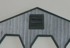

louvers going in.jpg louvers going in
this will be it for this wall, I will need to make tracings of the door openings, and then I can work on fastening these walls on the frame.

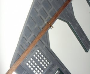

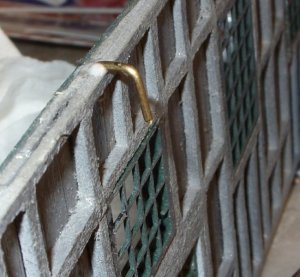

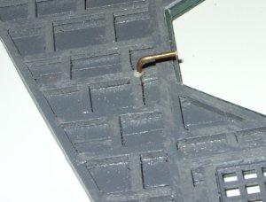

SML end wl w smp bm.jpg SML end wll Hk.jpg Sml sd wl hk.jpg My wife is watching football this afternoon, and I am in there working on the engine house, and watching the replays.
The back wall of the engine house is tacked onto the post and beam frame.
I drilled holes in the other three wall and have glued little brass hooks, designed to hook onto the post and beam frame, to allow removable wall.
The beam I used to test the hooks size.
The hooks are set into drilled holes in the walls and secured with white gorilla glue.
once the glue has set up I'll get you photos of the walls up.

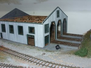

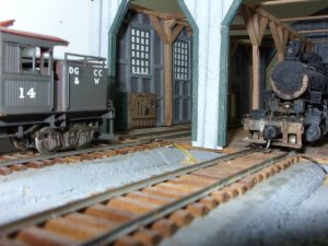

SML   CC E H dr opngs.jpg SML  cc eh wls rdy #1.jpg SML # 21 @ hm.jpg SML CC RH Nw .jpg Yea, we are watching the Titans, the beginning of the season was ugly, My son Is @ Miami of Ohio, and I understand the Bengals season has been painful as well.
I got the walls up. I had some temporary clips, and the permanent ones are just an improvement on that idea.
Spikes stuck into the homasote concrete hold the bottom of the walls in.
Now that there is a shops building maybe the shops crew can finally get around to fixing the paint damage on the nose of # 21, that occurred when I I built the freight pilot for it.
