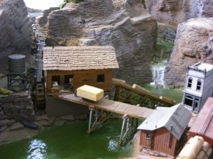

I have done wooden shake roofing, with micro tiny shakes cut on my 4 in. table saw and split with a single edge. That's what I have on the Strong and Perry Lumber Co, up in the Gizzard. It looks really good, but would be highly unlikely on a building dedicated to housing wood and coal burning locomotives. It would be too much of a fire hazard.
I have enclosed a photo of that building. One thing about it's red oak shingles, is they hold dust like crazy. I need to clean this roof thoroughly, and shoot it with some kind of clear coat to see if that helps . The problem is, I built this building more than 32 years ago, and I'm afraid that cleaning it thoroughly might cause damage. This was the second or third model I built up plank on frame.

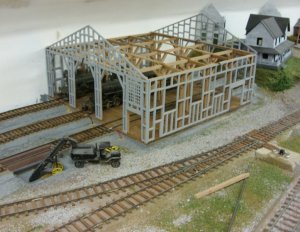

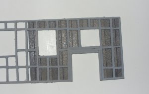

SML #21 @ hm.jpg SML CC EH wls clpd on..jpg SML tmp wl clp.jpg I got the frame mostly squared, or as close as it is going to get. as I was messing with the frame the walls kept falling off the foundation, so i stuck some spikes in the floor that stick out and catch the bottom of the walls.
When the walls are planked the blanks will cover the floor, an the occasional 55 gallon drum or stack of lumber will keep the inside of the walls in.

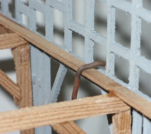

I made little clips out of stove wire, like I use to twist up tree armatures to hook the top of the walls to the frame, so I don't have to have lumber propping up the walls anymore

Bill, to clean those cedar shake roofs of dust try some canned air stuff you get at computer/electronic supply places. Or regular compressed air at low PSI. Blow straight down on the roof very gently and it should clean out nicely, even comes with a little straw like WD40 to get in the fine areas.
BONUS: Tip the can upside down and spray, instantly freeze anything almost like liquid nitrogen!

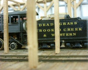

I'm sure Dr. Tom will want some so I took some preliminary interior shots through the doors. I think I'll build it so the outside wall will come off too.
Bill Nelson
Great interior shots Bill. My fav. is the one with the DGCC&W locomotive in the house.
As you know my favorite perspective of these neat models is a HO little people eye level. Having a removeable wall will allow some pretty neat shots of your beautiful engine house and the well detailed interior to come.

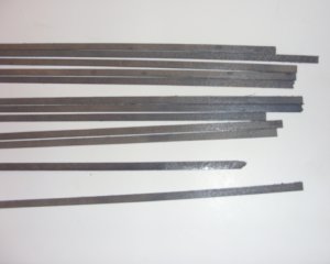

SML RR rm dr.jpg SML swdst prductn.jpg been busy but trying to move some on the engine house
I have had very little RR time, as I have been working on my ,on floor bathroom, a back porch converted to a bathroom back in the 30s or 40's.
the wall and most of the floor, all of the plumbing, and most of the wiring had to go, so it has been akin to new construction, except working with a space that has no level, plumb, or square surfaces.
the foundation has been rebuilt, along with the floor (my vinyl isn't here yet, nor is a custom ordered window ) the floor is insulated and the outside wall in insulated, and I'm getting close to having the ceiling insulated, but it has ate most of my time.
Sawdust's work has been inspiring me, so in my breaks I have been playing with the saw, trying to find the right wood for the Crooked creek engine house.

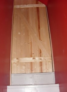

earlier this year, when I was working on the back hall, I built a door to the RR room out of some nice, super thin tongue and grove pine, to replace a cheap plastic folding door, which couldn't keep a determined cat out of the RR room. the leftovers cut well, and it looks like these may be my planks.

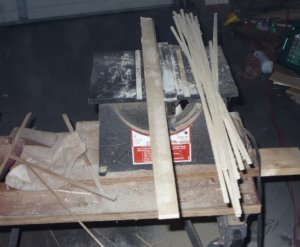

What kind of a saw blade do you use?
The accurizer kit I bought for this saw came with a thin carbide tipped blade, and that is what I still have on it.
These dremil 4 inch table saws are belt driven, as well as being underpowered. one must feed it very slowly or it will stall, or throw the belt. I also have to keep the feed rate constant, or the blade will leave scorch marks on the wood.
I have purchased a diamond blade, which looks just like a disk, but have not tried it yet. I'll try that next time I go insane, and try to do red oak shingles. this saw is not really stout enough to do red oak, although it is forced to from time to time.

I've used the little diamond blades to cut ceramic tile with. I have no idea how they would be for cutting wood.
Sounds like your 4' was built to cut pretty light stuff, although oak is a challenge for any saw.

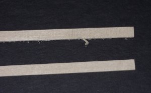

It is wimpy. It isn't produced any more (my guess is someone sued them, as it is worse than useless with the safety ****** on it, like most table saws). It is just powerful enough to destroy a finger or two. If I were to suddenly have an excess of cash, and income out the wazoo, I'd buy a Jim Bynes (sp?) saw like the model ship guys swear by.
I have that stack of lumber on the kitchen table as I cook my Dinner. The wife isn't here or this would be a no-no. I'm rebuilding the bathroom, so sawdust in the kitchen can easily be blamed on house improvement.

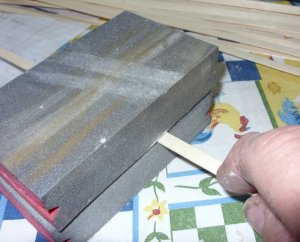

Before I paint this wood, I'm knocking off the fuzz. I have two fine sanding blocks, the kind made out of spongy rubber. I bush down on the blocks with one hand, while drawing the wood between the bocls with the other hand. in the photo the hand pushing down on the blocks is missing, as I didn't have a third hand to push the button on the camera.
I also have a photo of two strips of wood one of which has made the trip through the sanding blocks, and one that has yet to do so.
