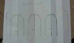

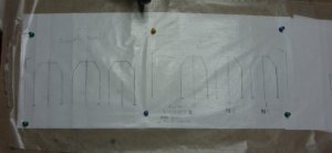

I had made templates of the actual door openings by tracing the openings on paper. I folded the paper to get the center line of each door opening, and this was drawn in with ink to be more visible. I then flattened the paper out, put it on my build board (a piece of homasote), and thumb tacking wax paper over it, so I can build the doors on the template.
A couple of days ago I fired up my 4 inch table saw and cut planks out of the same pine I made the walls out of, except I cut the planks for the doors thinner. Yesterday sanded the fuzz off of that material and cut them to a length just longer than what I need for the door (you can always trim or sand some off- you can't add any more on satisfactorily)
Next I pre paint the boards grey, and then begin assembly.

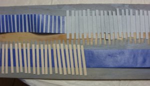

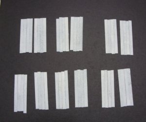

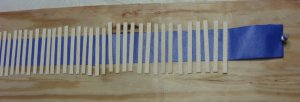

SML ct t sz.jpg Sml rdy t pnt 1 sde.jpg SML th brds stck tgthr.jpg Sml trnng brds ovr.jpg Pre painting the boards with spray paint had a very helpful and totally unexpected benefit. the paint was slightly sticky so the boards would stick to each other making trimming the wood to size much easier.
If you look on the second photo from the top, you see the boards, just slightly oversize getting taped down for painting the grey (inside) side.
In the photo on the bottom, you see me turning the boards over to paint the outside .
the third photo shows the boards stuck together to make approximate door shape.
The top photo shows the door shapes roughed in.
after I get the bracing on the back side , I can sand the doors down to their perfect shape, and then it will be time to get the tiny brass wire, brass tubing, and brass strap, and start to try to make hinges, hoping I can find an easier way to do it as I need 12 pairs.

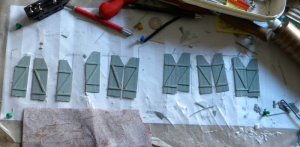

SML eh drs.jpg SML eh drs.jpg Here is a pic of the doors ! the camera is replaced. I got a better camera, so I have a learning curve in front of me.
Next is to make the hinges. I have a Hockey game tonight, so I won't get started on that today.

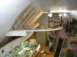

The far end of Gegokayoosa sags a little ( it is a shelf hung off of the ceiling.) The sag could easily be ignored if that is the end of the line, but I will need to correct it if I add the return loop, so I can walk under it to enter the train room. If I do that I could also lengthen the shelf under it that holds the Georgia staging some. and use both shelves to help support each other.
From the photo, you can see the trickyness involved with building this close to the ceiling. If you look at the pictures way back in the front of this thread you may be able to see the Harlow Terminal, which this building is intended to mirror.

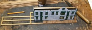

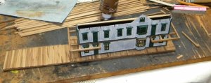

In any case I was up there looking at the top shelf, which is very plain as of yet, and I decided to work some on the Stateline Terminal building, which, will be a mirror image of the Terminal @ Harlow, except the Harlow terminal is a complete building, whereas the Stateline Terminal is too close to the ceiling, and thus it has some interesting challenges to modeling it.
I had already made a frame for the platform. The walls are kitbashed from a small rural station kit. I bought lots of them, and I have made my two terminals, a freight station, and at least three smaller stations out of the pieces.
Last night I cut planks for the platform out of the extra cedar I had cut for ties for the sawmill complex at the club. after I had the platformed planked I set it up in place with some of the cedar beams like what I used for the bridge @ the sawmill complex @ the club, and for the beams for the Crooked Creek engine house. from looking at the test fit, it looks like it will work, so next I need to cut the beams and glue them up to make the balcony for the second floor of the Terminal building. I'll have to study my supplies, most likely I will have to buy more grant line porch posts, corbels, and railings to finish this model off, as well as some Atlas passenger platforms like I used for the Harlow terminal, or I'll have to scratch something similar.

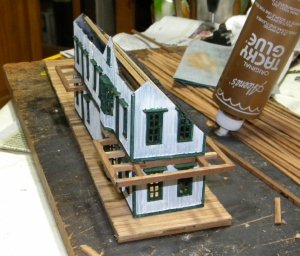

SML SL un Trm #1.jpg SML SL UN TRM #2.jpg State line Union Station!
@ Stateline Ga. 3 railroads meet My DG,CC, & W RR, My Friend Mack Montgomery's Marietta & North Georgia (dual gauge, as a Narrow gauge branch line meets the standard gauge main @ State line). Also there is the narrow gauge State Line Railroad, a 3 foot gauge RR , which is a joint Venture between the M & NG, and the DG CC & W RR, providing logs and iron ore to both railroads,
To match the look of the Harlow terminal, I'm going to have to order a bunch of Grant line porch posts, trim and corbels. I'l have to study the Harlow Terminal building carefully to figure out what I need.

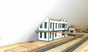

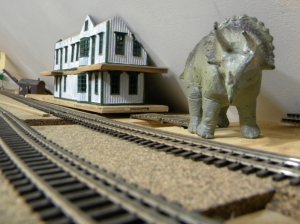

sml sttn & Buford.jpg here is the station in pace with Buford, a local resident.. I really need to do some ground cover and ballast up here.
