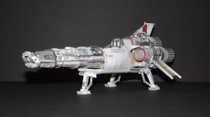

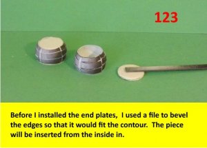

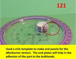

Great work on the landing skids. Keep up with the updates, since I keep track of what you guys are doing to help with mine.

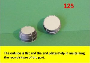

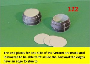

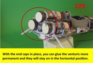

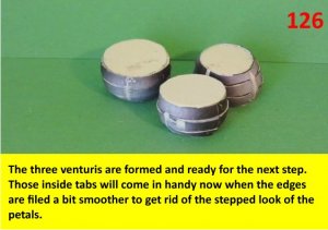

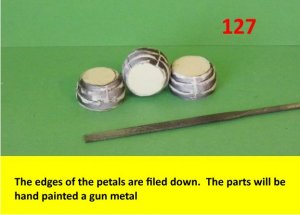

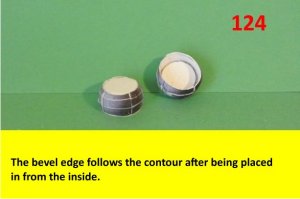

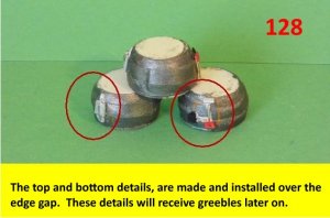

Here are some more photo updates on the after burner venturis. The end plates serve as a support, to maintain the shape and to serve as a flat surface to adhere to on the bulkhead. Enjoy and see you all next posting.:thumb:

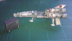

EXTRA components (Tool Box)

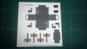

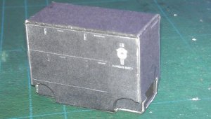

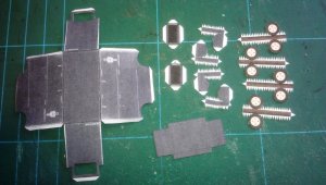

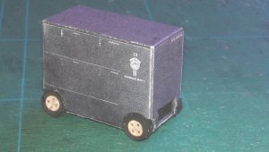

Here is the Tool Box (made by Revell-Fan) in 1:50 scale.
This will be going to be part of the diorama.
Here is the parts sheet.
All of the parts.

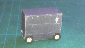

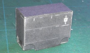

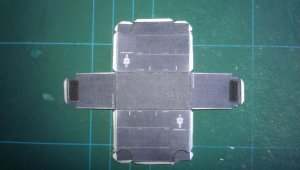

The main box.
Main box is assembled.

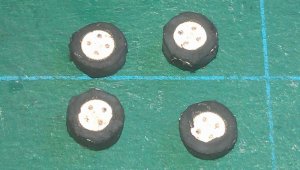

The wheels.
Wheels attached.

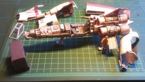

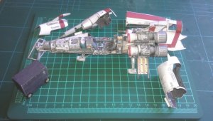

The box next to the Viper

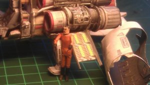

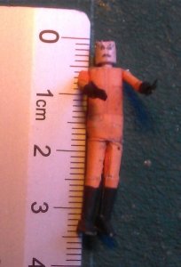

I used Tirick's X-Wing Pilot for the Knuckle Dragger (THANK YOU TIRICK!!!).
The only problem, is that i printed it out a little too small for the diorama. The figure came out to be about 3.4cm (which after doing the math, would make it 5' 5" in real life). Then again having a short mechanic is not a bad thing.
I will have to increase the size by 5% (at the most, to get the height that I want).
Finished figurine.
Figurine next to the Viper.
Close-up of the Figurine (next to the Viper).
ENJOY!!!

Call it "Cally" and there is no size problem any longer! :thumb:

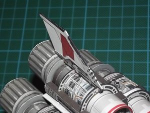

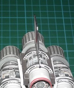

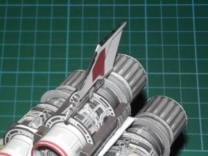

First of all I want to show you some close-ups of the attached fin. After assembly you will have to paint the edges to make them look better. However, instead of painting the edges completely black you should let the tecture "bleed into" the edge, so-to-speak. To achieve that I coloured only the areas embraced by a black texture. In the end it looks as if there are some components wrapping around the edge which gives a very interesting result. The part looks stronger.

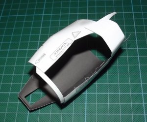

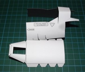

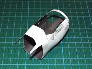

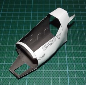

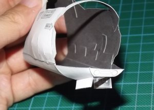

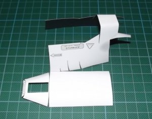

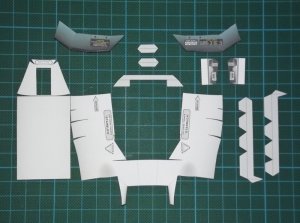

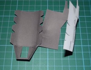

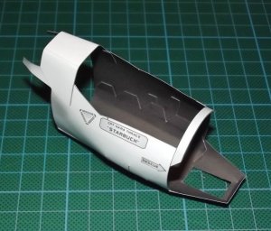

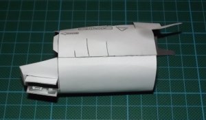

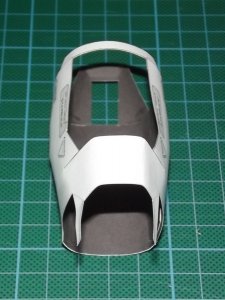

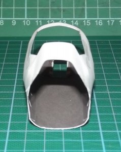

And now it's getting interesting again: The cockpit tub skin is coming.
All parts have been assembled according to the original instructions. I made some glue tabs from scrap pieces (of one of the pages with the printed back). They were used to connect the slits at the sides from the inside in order to get a smooth surface.

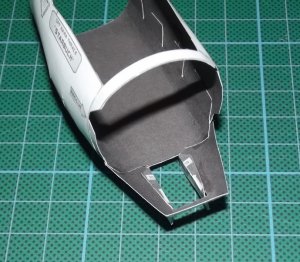

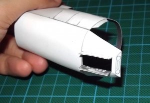

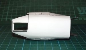

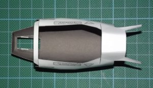

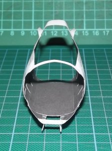

Be very careful when you are pre-shaping the parts. I rolled the part over a rod and a pen several times to get the correct shape. The following pictures give you an idea of the final look of the curvatures.

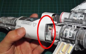

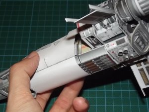

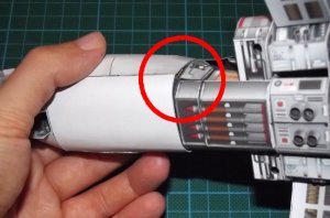

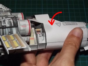

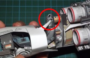

And now the mounting: Turn the skin about 90° and put it over the nose. When it reaches the back of the seat turn it up. Take special care of the "hoses" on top of the head rest, they prevent the part from rotating freely. You have to manually lift one of the flaps over the head rest while rotating the skin. Then it is CAREFULLY pushed over the cockpit area. You might encounter some problems at the back of the cockpit tub because the skin may be a bit tight there. I have marked the areas in question in the pics. It is: the former at the back of the cockpit, the small boxes behind it and the missile box at the bottom.
Do not force anything.
If you feel any resistance take the skin off again and press the troubling parts on the fuselage in place gently. Then try again and pull the skin over the areas by using a pair of tweezers and by applying some pressure to the skin with your fingers from the inside of the cockpit tub (see red arrow). Do not press, push and pull too hard in order not to break anything.
Once the part is in place you may press it gently to shape.

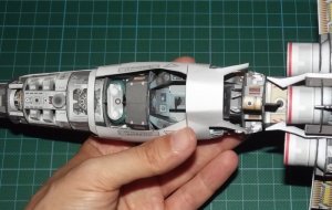

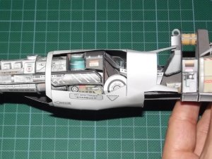

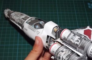

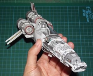

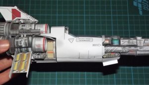

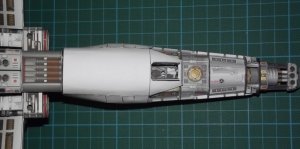

The skin is in place - and can be removed again!
