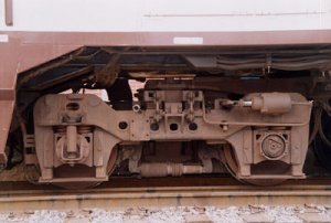

A Real BB+BB truck
Hi lv4142003,

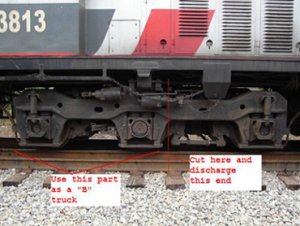

I know that model. I was presented at the annual Frateschi HO model railroading contest. The loco uses a BB+BB truck made from frateschi U20C trucks. The author cut one axle of Frateschi truck (3 axles) and use just two of them. The model became great to a non expert model railroader, but for those how like real prototypes models it is not good. The reason is simple: the Frateschi trucks are totally different from the real trucks used by BB+BB units. Please compare here bolth of them and tell me if you agree with me. I intend to model a perffect copy of a real BB truck made by Cruzaco....and powered! That dash 9 is not powered on all trucks.:)

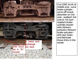

PedroP, thanks for the update. I kknew I found it on a Brsilian website. I didn't think it was powered, but it was clever using the U20C truck. See the attached photo. After I saw your last 2 photos I played around with some ideas and remembered a guy built a SDL39 truck chopping up an Athearn GP and SD trucks. I'm looking through my files looking for that article. He used the GP for the gears and modified the SD for the odd spacing of the SDL39. Thanks Joe <lv4142003>
