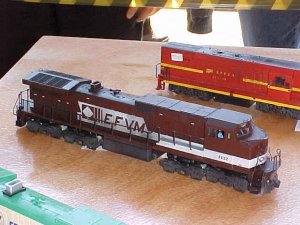

PedroP, I'm attaching a photo taken at a Brasilian model show/contest. I don't know who the modeler was nor where the show was held, but this is from a Brasilian website. I also bo not know if this unit is powered, but it looks great. There was another photo but I will have to find it. Joe <lv4142003>
