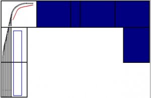

OK, after daaay's of many hour's sitting here trying to decide I finally got my bench work how I want it and it is a permanent stay. I've gotten the yard drawn out how I want it but I can't seem to get two locomotive servicing tracks, one A & one D track (two tracks total for the A&D) and a RIP track to fit in without interfering with the switching lead. I want to be able to bring a train in a pull a train out of the yard while the yard switching isn't disturbed. How to tie this yard together with the corresponding thing's I have no idea. I was going to throw in a locomotive escape track but that I don't also know about where to put it.
I have decided to keep the layout single level do to the weight of a multi deck layout plus the complication of building it in modular form so I am leaving this bench work plan as is because one day after it is built I will move and I plan on adding to it later. Speakin' of adding on to it later on. I want to keep at least one line as a true main line because I will want a continuous run later on down the road but for right now just a mainline with lot's of switching.
The following diagram goes as follow's.: Red-main line track but I would like to have the RIP, servicing and A&D tracks tied to the classification yard with the main line running on the outside of the layout. Dark Gray: classifaction yard. Light Gray: switching lead.(note: need's to be longer to fit a train long enough for the yard. Blue: "roughly" where I want the A&D tracks, locomotive servicing tracks, and RIP track to be. Dark Blue (70% of layout) for any switching idea's you guy's might have or be able to come up with. I have drawn up a couple design's but I junked them simply because they looked like a track plan for something in the 40's and 50's era. I'm looking for more of something to fit into the "NOW" era. lol.
I swear up and down.:curse: :curse: :curse: I've been trying to build a layout for almost 6 years now and my room dimensions keep getting changed because of moving or somethng big and new like a $5,000 drum set keep's running me out of room. I'll be damned this time though. I'll build it and if space becomes a problem hen we move in our own place then I'll just go buy a 15'x24' already built portable shed building for MY layout room.announce1 :D I pln on doing this anyway, that's why I'm leaving it to be added on to later. Just not this year.

You definitely don't want the yard to be on the backside of the layout. It makes it hard to reach and if anything fails you'll be cursing the whole thing. Also, there's no need to make the rails parrallel to the table edge. Try running them a few degrees off the parralel so that the first turnout is closer to the inside corner of the curve.

Thank's for that link Shortliner. Someone (may have been you) posted that lin about a year ago and for the life of me I could never find it and it happens to be one of the main one's I have been looking for, for a long time now. Loudmusic, I thought about that. I really wanted the class. yard towards the outter edge of the benchwork. Pretty much just flipped over with all the other tracks near the wall. I just couldn't see how to make it work without having a tight curve into it. Lemme play around. I think I just saw an idea.

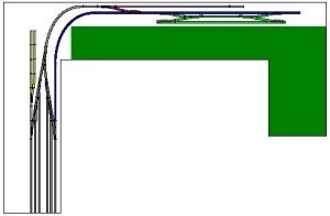

Well, after taking a day off away from any planning here is something I came up with. This yard design that I took from another layout drawing gave me 6 tracks and 1' extra to play with and fit in the A&D and RIP tracks. The green track I added from another drawing. Now I'm stumped as to what kinda industry switching I can add and make work with what have. On the left of the picture the mainlin will continue strait for future addtions. Anyone have any idea's of what else could be put in? I need a locomotive escape track in the yard still but don't know where to put it until I have a A&D track. Maybe an A&D and RIP track on the other side of the locomotive servicing tracks? If so how could I get it in there without once again disturbing the switching lead but yet still have access to the whole yard without a cross over? Any suggestions coment's and idea's would be great. Thanks.
