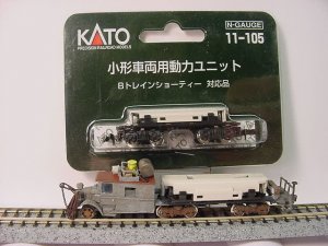

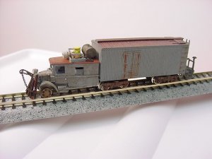

Spent my Thanksgiving huntched over my workbench puting the finishing touches on my little Goose. Rushed it it places when I shouldn't have but I'm pleased with the results. The little thing runs like a dream!

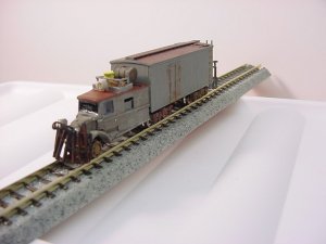

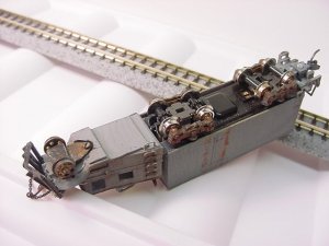

The front truck was a nightmare, I could not get it to stay on the track when it went into a curve. Solved the problem with a floating weighted type arrangement. Drilling the thru holes in the metal wheels was very time consuming. Think I went through a half dozen before I got the results I was looking for.
