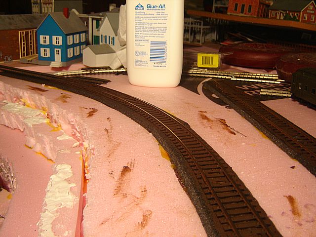

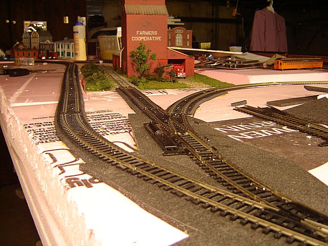

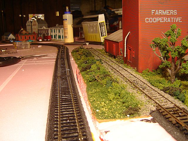

The next part of the RK&M will involve connecting the railroad to the Grain Elevator Diorama and extending the main line past the grain elevator. I have begun to lay out the track configuration as seen in the next photos. In the photos the main line will be on the side of a hill/mountain. On the left side at the bottom there will be a stream/river. On the right will be the other side of the mountain. Eventually on top of the mountain the town will rest.

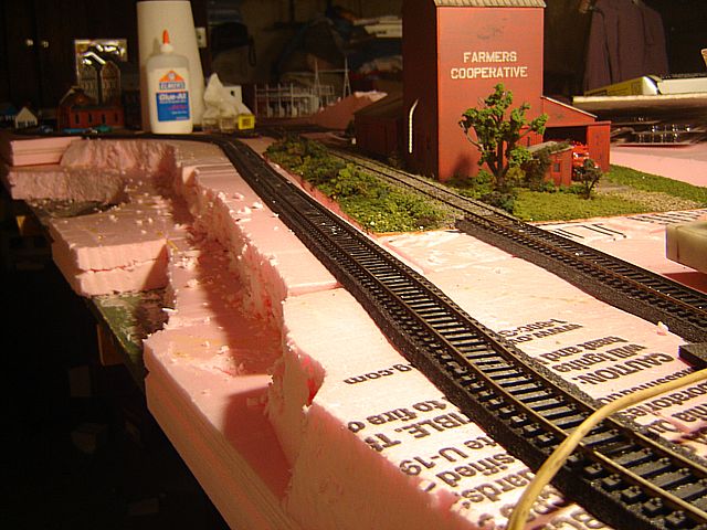

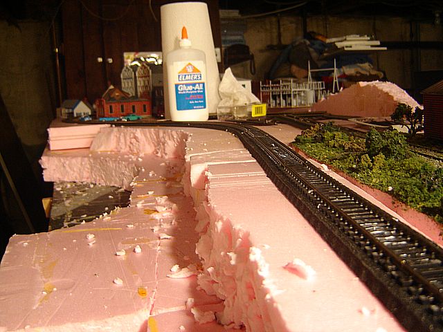

Here is another view looking the other way.

Nice work. I like the way the track is not "arrow straight". Gives a real branchline feeling to the whole thing.
That grain elevator is also very nice... :D

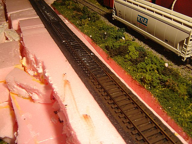

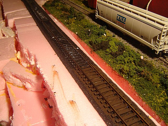

I have finally gotten the road bed attached after several abortive attempts to do it. I had to glue down the foam base several times before I could attach the road bed.

This is a nice "how to" for using foam Tom. I think a lot of people will appreciate following along. By the way, that grain elevator looks great!

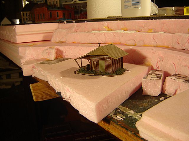

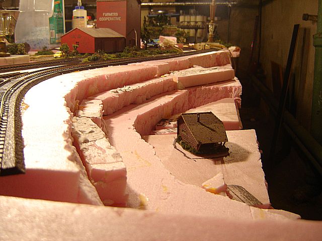

I glued down some more foam to help space the hillside. I also added the Hunting Cabin. Well at least the approximate spot where it will go.

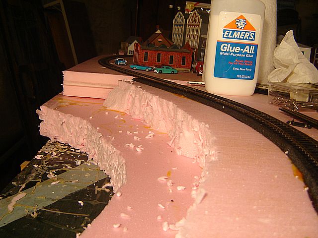

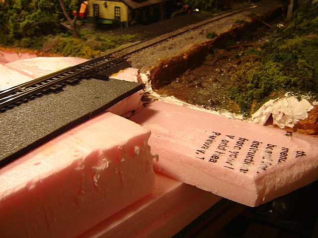

And here is where the Passenger Station Diorama will tie in.

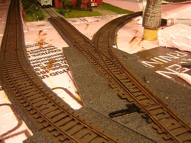

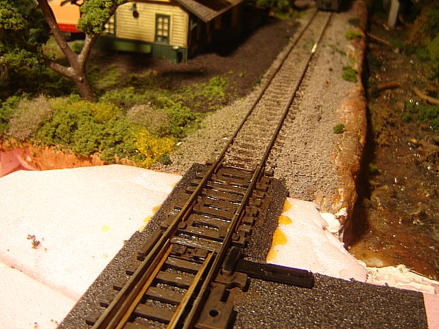

I began weathering the track.
First I brush paint the sides of the rails and the ties with unthinned (straight from the bottle) Folk Art Asphaltum. It will take two coats to cover everything correctly. I slop it on pretty thick. Whatever gets on the top of the rail i remove with either my finger or a paper towel.
Here are a coupl of progress shots when I was halfway through the first coat.
Here is where the track blends into the Passenger Station Diorama
