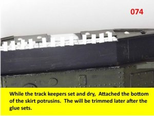

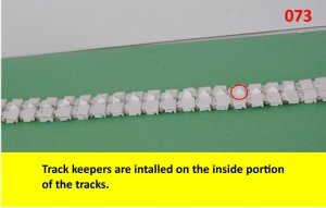

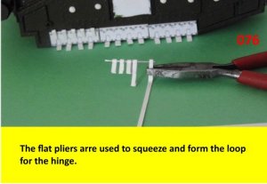

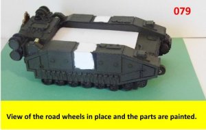

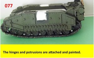

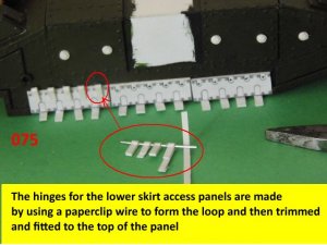

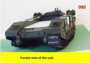

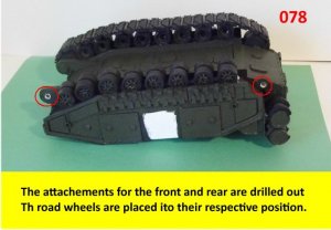

Well, it has been over a week since I posted. I lost my server signal and went to another provider. Now I am back with more updates on the build and I have over 100 more photos to edit and up load. Here is the next batch and see you all soon with more and more.:thumb:
