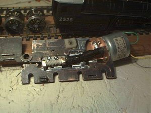

This is a Bachmann repower I'm working on. I drilled the drivers to take an axle to get rid of that annoying plastic center sleave that always splits. The worm is adjustable like an old set of points in a car.

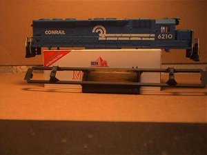

A scratchbuilt brass frame for this RPP SD45 I painted. Oh when someone askes how I painted that, I usualy reply, Either with a frozen mop or a dead cat.

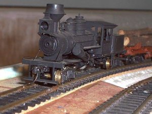

Dewey Az.

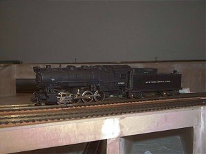

That's an area where I need some advise. As you can see my locomotives are to clean. I need to learn how to weather.
Like this one , It's to clean

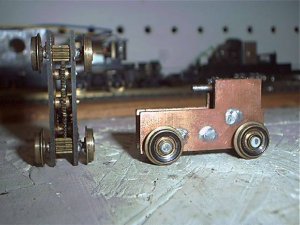

These were a get to know your lathe and milling machine project. Lots of OOPS's, but they acually ran smooth when hooked to a motor.
THE WORMS ARE PEICES OF 1/4" ALLTHREAD.

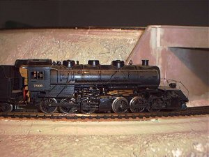

Dewey Az.
This is one of my earlier kitbashes. A Tyco Boiler on a scratch-built chassis. Weight is transferred to the drivers by way of a hinged weight that is hinged over the rear center drivers and rests on a slider that protrudes through the bottom of the boiler just in front of the front center drivers.

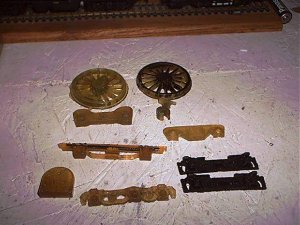

These are resin castings cast in wax molds. I want to try silicon molds one of these days. The wax molds don't last very long.
