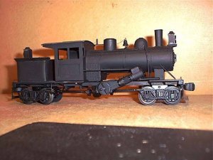

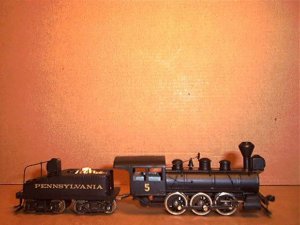

I took a few quick photos of some kitbashes and scratchbuilds I've cobbled together.

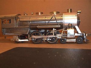

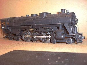

This first one is the Lionel hudson I could never afford. Built mostly of sheet steel over a Lionel motor.
Five star work there Ray. I know some O scale people that would be envious of your work. In fact some P:48 people would leave a puddle of drool on your floor. Great work, and please do share your secrets.
Thanks for the compliments. Actually you are some of the first to see some of these.

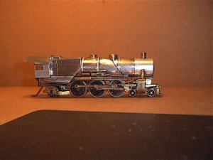

As far as working with steel, it's not that different than working with brass. A little harder to cut, bend and roll. Machining takes a bit more patience as you need to take lighter cuts using cutting oil. That gets pretty messy.
Most of these were built before I got the lathe and milling machine. You don't need fancy equipment to build a locomotive. (but they are fun to play with) The atlantic was the only one using them. tha boiler was a peice of black pipe turned on the lathe, cutting the areas between the boiler straps and the smokebox, then laminated the smokebox with apeice of embossed beercan. I cut the othe end and spread it open to form the firebox. The other boilers were rolled sheet steel and soldered, which I would recommend doing, it's actually a lot easier.
The drivers on the atlantic have mini-ballbearings from VCRs on the axles. Speaking of the drivers, what do you think of those thread spools.
I would be glad to share my secrets to to keep this so called "dying breed" of scratch building alive. I wouldn't know where to start. So please ask, hope I can help.

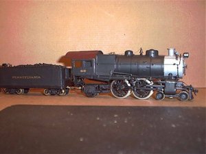

An HO steel E6
Now Ray,,,,, how about trying an Interurban,, say Pacific Electric?
I would love to see that in steel ,H O of course..
With the rivits ,,,,,,,,,,,,, sorry I just drooled
The drivers on the atlantic were fabricated from thread spools with extra spokes added and a brass tire bonded in place. these ones were made with the lathe, but I've made others without it. Without the tire using the tender for electrical pickup.
As for an interurban, that's something that interests me, need to do some research. I did have a small line on one of my earlier layouts but compared to what I've seen of yours mine was rather crude.

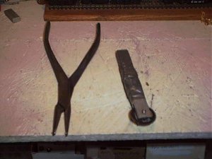

home made rivit tools
