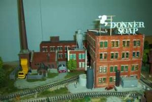

Inkjet signs
Inkjet signs seem to bright and new looking for me, so I weather them by hanging them in a window that gets direct sunlight and watching them fade until they suit me. It takes several weeks so plan ahead. Lighted signs can be made by printing on inkjet overhead projector film and cemented to white styrene. When backlit they look like the plastic molded signs that lots of businesses use. Quick signs can be printed on inkjet return address lables and then cut and stick. Inkjet iron on transfer paper can be used for signs on some materials and finishes, but don't stick to well to bare styrene. Use your greeting card program to print big block letters on card stock, cover with clear package tape, cut out and glue to wood frames for rooftop signs from yesterday.

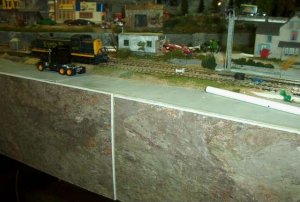

Now that you guys did the cart, here's the horse.:D Facia... Go to Lowes or whatever and buy some vinyl tile and some floor adhesive. The tile will not stick to bare wood so I use the adhesive to prep the wood, then cut the tiles in 1/2 and stick em on. They are cheap at $1 each so 4 foot costs $2 and change. Looks better than bare wood, or painted wood, or raw foam... FRED

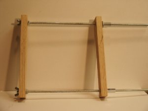

Folks I needed a clamp bigger than the small I had and smaller than my heavy large ones so I made my own. I've attached a photo if anyone want more specifics just ask but I think the picture says a thousand words worth. I plan on routing a slot in the center and with nuts and bolts add an L bracket on all four sides so things can be clamped on four sides at once.

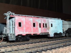

For those of you retired folks out there with alot of time and no money, here's a slow and easy weathering technique for you. Place the piece you'd like to have weathered out in a favorite outbuilding on your property, ensuring that all manner of birds, snakes, rodents and other creepy crawlies have unfettered access. Remove anything that impedes the free flow of rain, snow and other weather related discomfort. Then wait...for six years or so. Bring it in, dust it off, add new trucks and couplers to replace the ones that got et up by the passage of time and---Woo Hoo!!!--- a bonified weathering job that would put the mighty Southern Pacific to shame. Whuddayathink?
