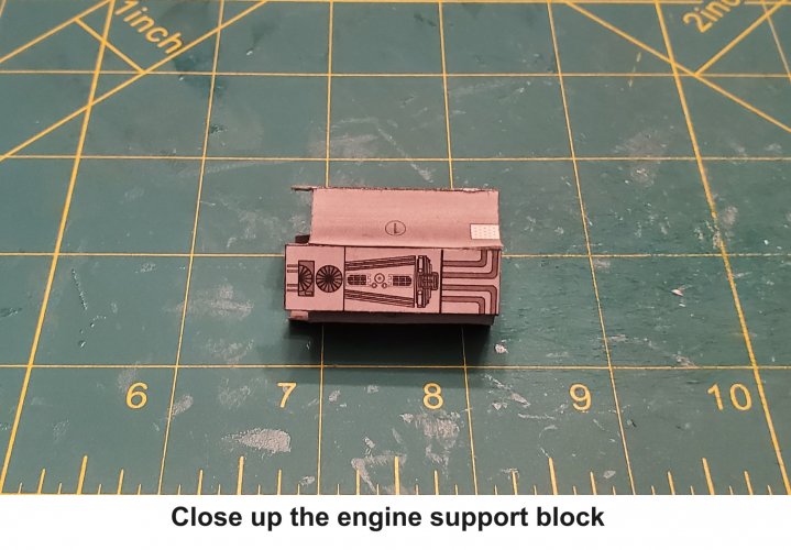

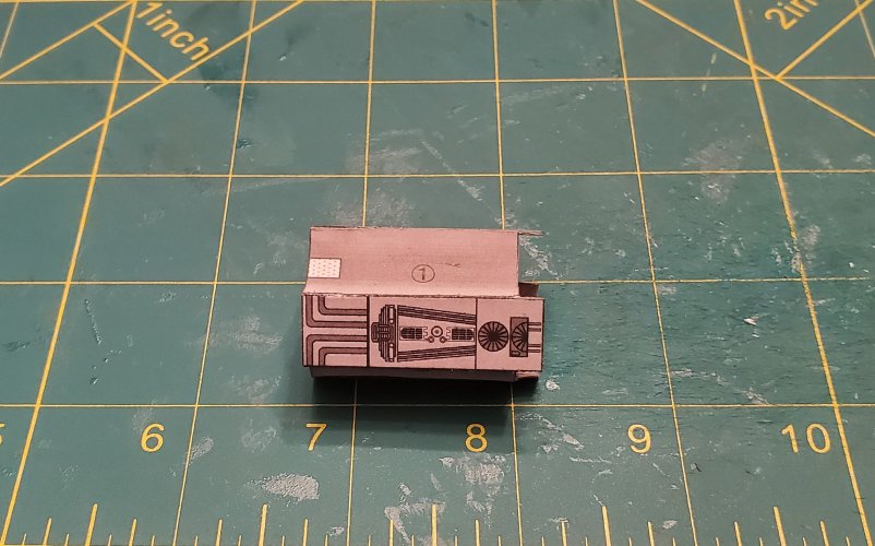

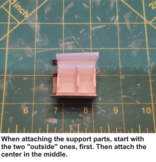

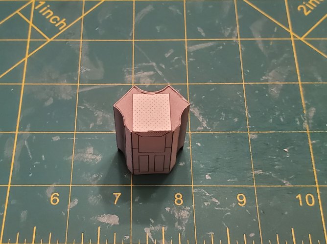

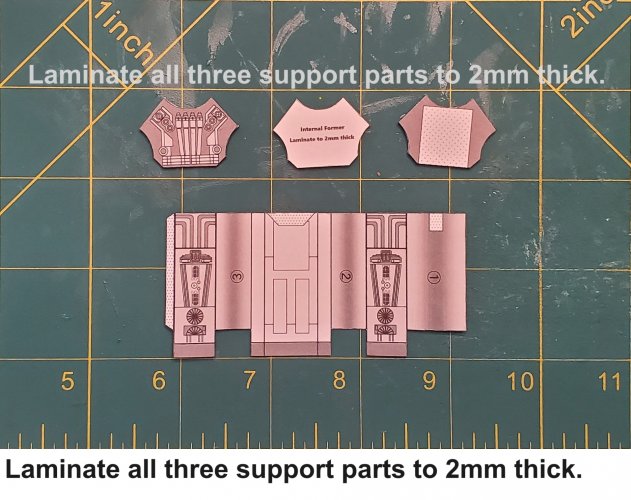

I start with the engine mounting block. I have added a supports former to be placed in the center.
I attach the support pieces to the skin.
The engine mounting block is assembled.

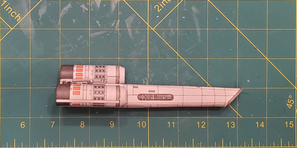

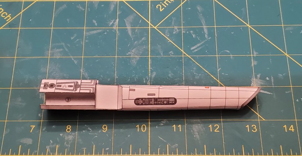

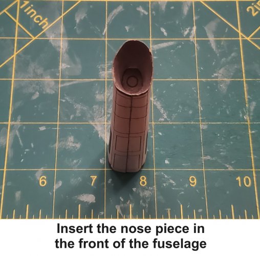

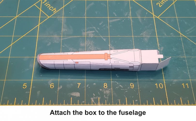

I assemble the fuselage.

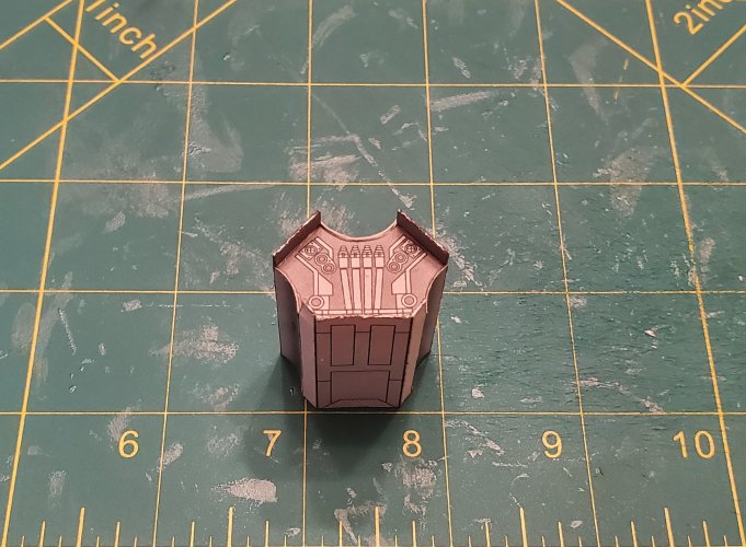

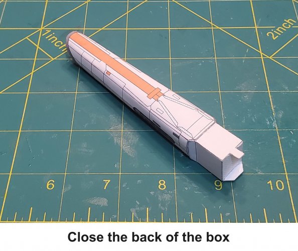

This is the box that connects the fuselage and engine mounting clock together.
I assemble the box (but do not close it up yet).
I attached the box to the fuselage.

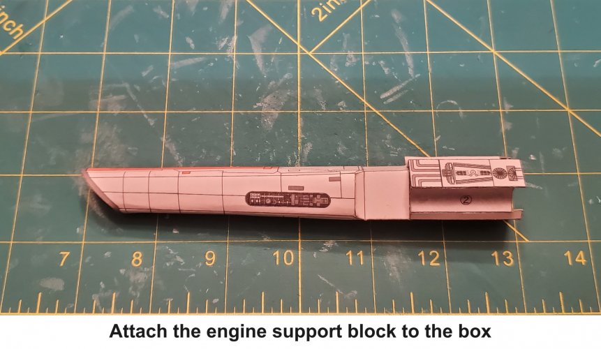

I attached the engine mounting block to the box.

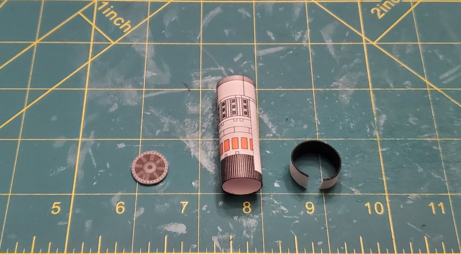

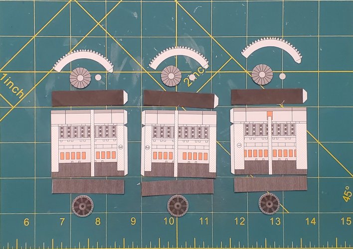

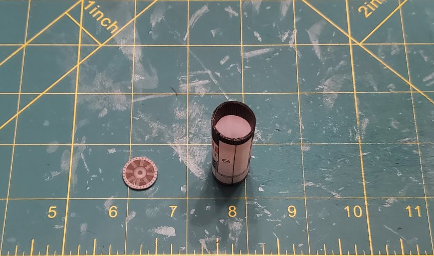

Moving to the engines. Here are the parts for the engines. I have laminated the fan plates and exhaust plates to 2mm thick; and the fan spindles and inner exhaust rings to 0.5mm.
Attach the fan spindle to the fan plate.

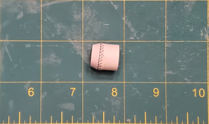

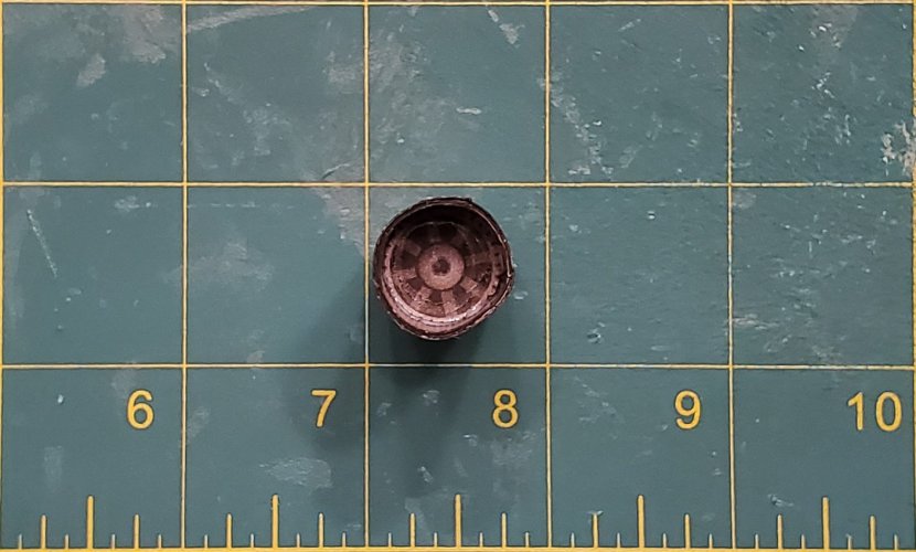

Form the intake cowling and intake ring.
Attached the intake cowl to the intake ring.

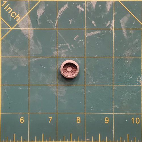

Attached the intake fan to the intake ring.

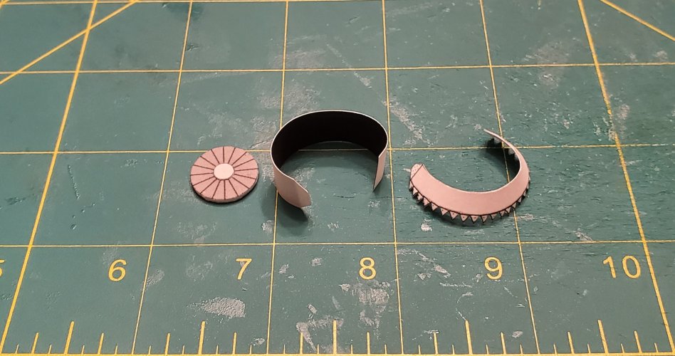

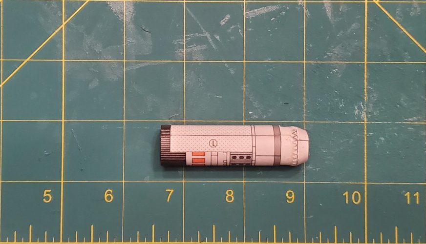

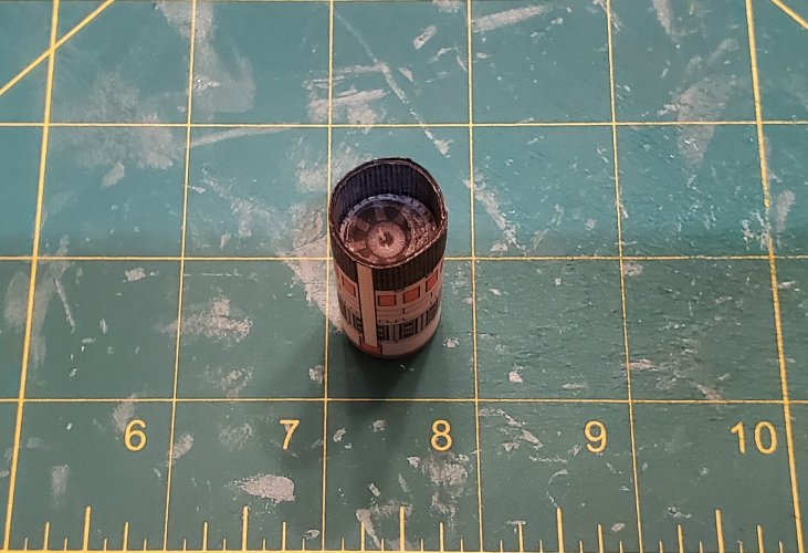

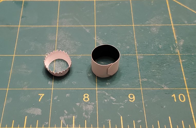

Formed the engine skin and inner exhaust ring.
Attached the inner exhaust ring to the inside of the exhaust.
Slid the exhaust plate into place.
Slide the intake assembly into place.

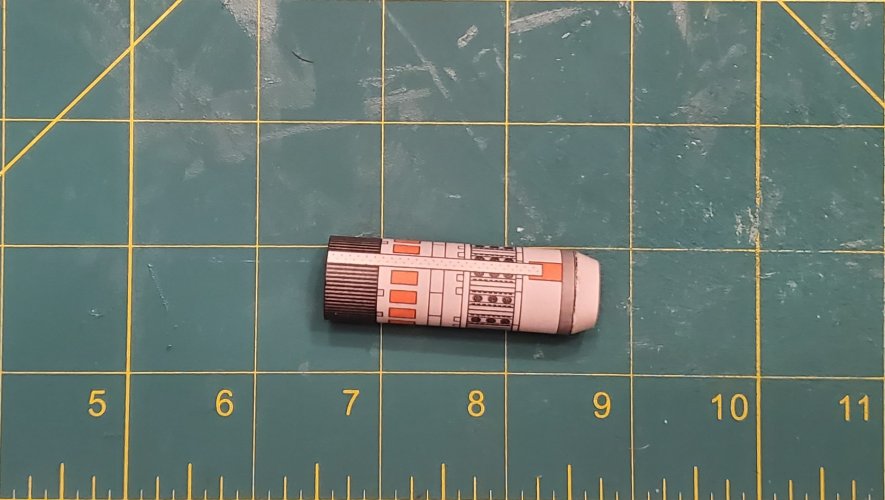

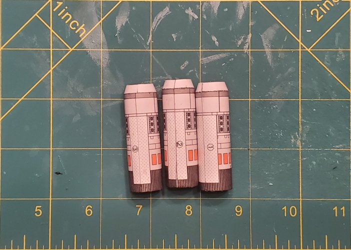

The engine is now complete

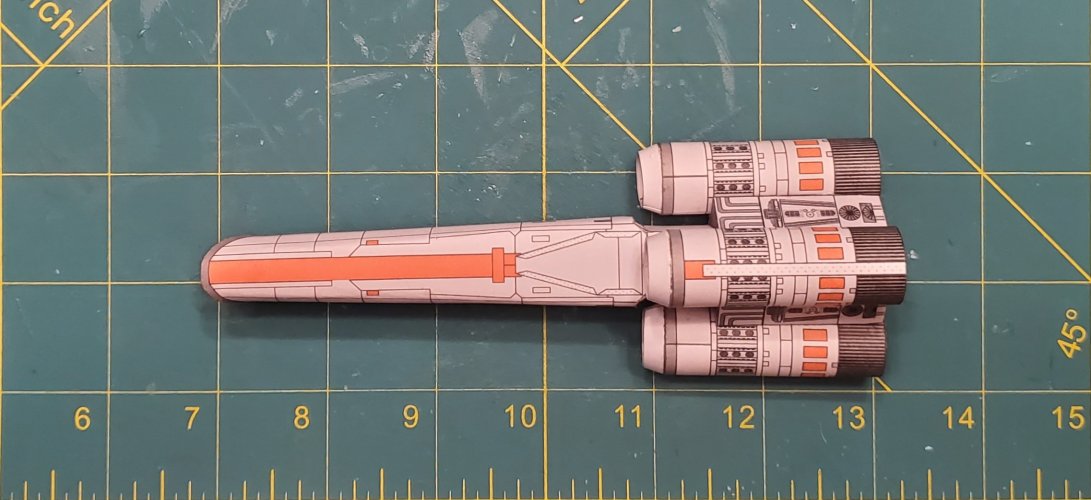

All three engines are now complete.
*NOTE* Each engine is numbered.
The numbers on the engines correspond with the numbers on the engine mounting block.
Engine #1 is attached in place.
Engine #2 is attached in place.
Engine #3 is attached in place.

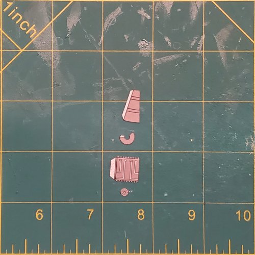

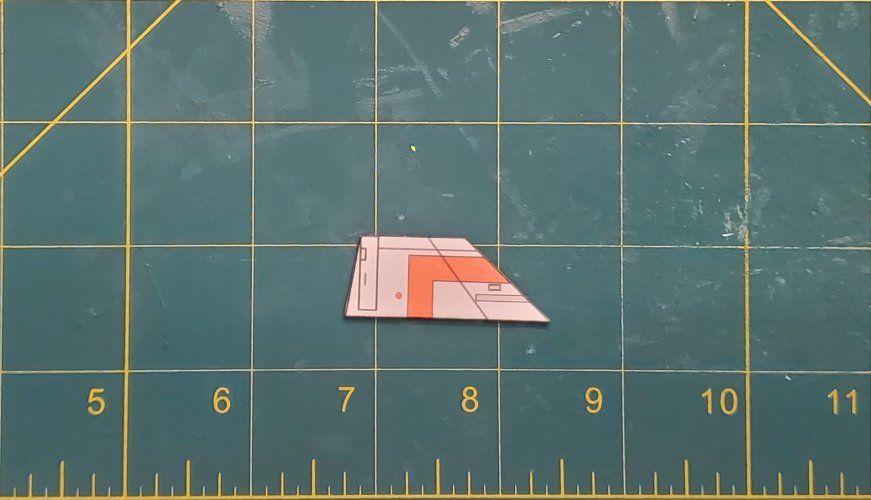

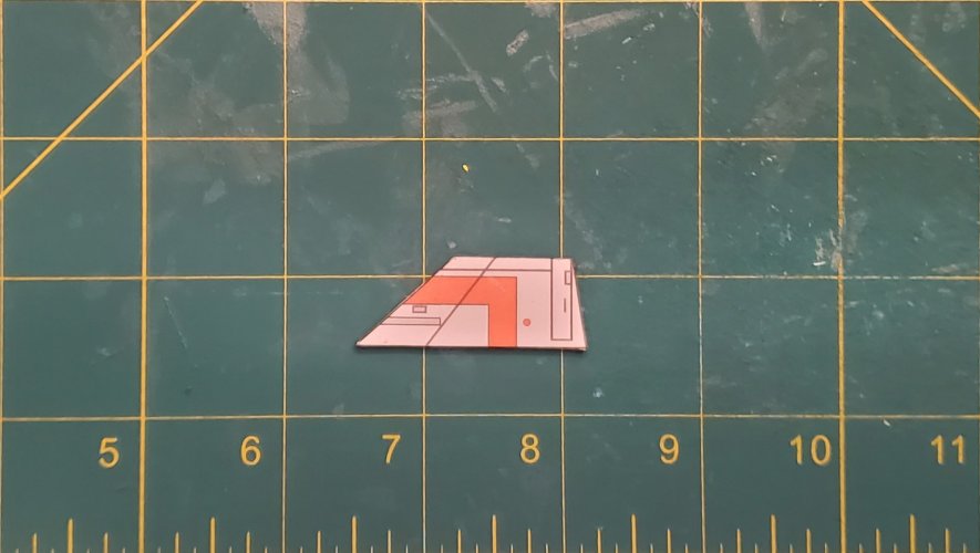

Here is the part for the tail.
The tail is assembled.
The tail is attached.

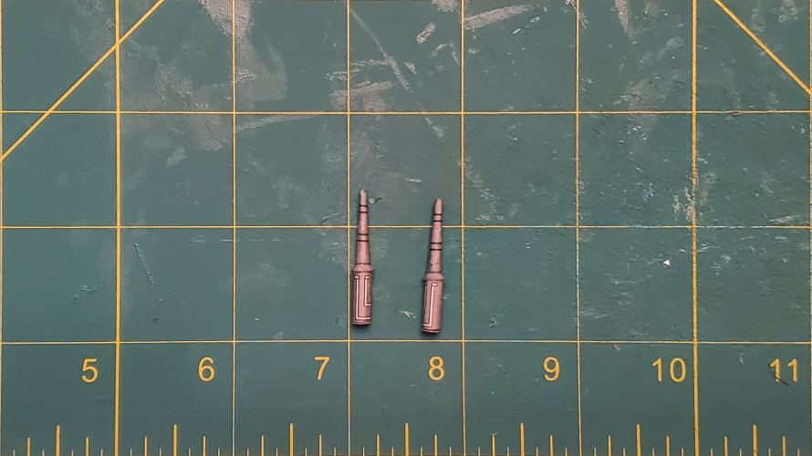

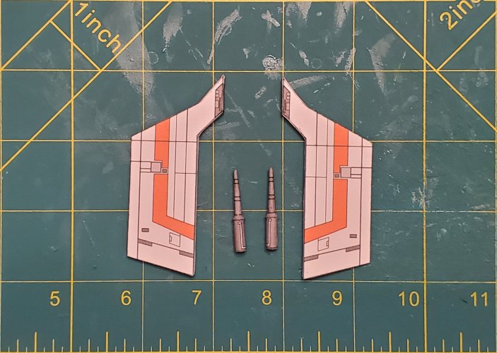

Here are the parts for the laser pulsar gun.

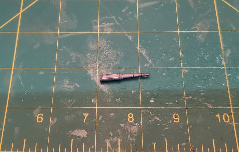

The laser pulsar gun is assembled.
Both laser pulsar guns are assembled.

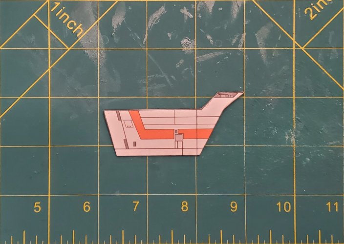

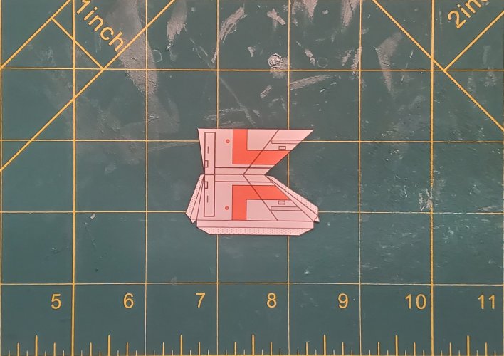

Here is the part for the wing.
The wing is assembled.
Both wings are assembled.

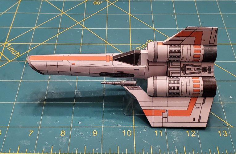

The laser pulsar guns are attached to the wings.

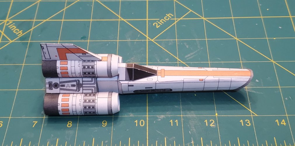

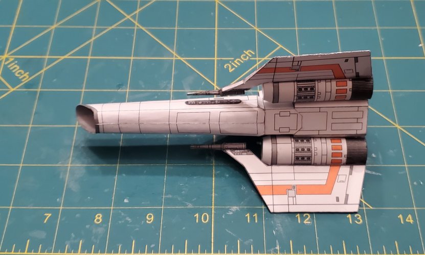

The wings are attached in place. This model is now finished. I will be focusing on the updated instructions for the new template.
Thank you for watching this thread. I hope that you enjoyed watching this thread as I did working on this project.
