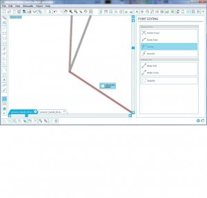

@wulf111, are you using control points to trace the outline, or something else? The Control Point method is laborious. After spending 3 to 4 hours with their ( Cameo Silhouette) engineers, only to find out I had a defective machine, I was sent a new one, I cut one model, and never touched it again.

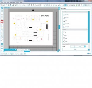

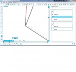

once I have the image file loaded into Silhouette Studio click on the "draw polygon" icon (picture 1). i then zoom in on the part i want to trace and click on the points i want to draw line (picture 2) one part is completely traced i zoom in even further (picture 3) and refine the points to exactly where i want them (picture 4). and i just repeat this for each part i want to cut.

You can do a complete model in minutes!!! You're a better man than me by far!! I know you can extract the boundary of the part and then enter that as a .DXF file, that was what I was going to do after I lost interest with the Cameo. These days, I usually use Rhino for machining things out of aluminum, or steel, etc. Not sure how complicated the models are you doing (as far as part count) that seems like an awful short time. Maybe I'll send you one of my models, and you can write the Cameo program for it!! I obviously suck at using it. I have programed 4 axis CNC machines that were easier! :)

depends on the model. i can usually do a page or so in 5 minutes i can usually go through a model in an hour or two depending on the number of parts per page. the SDF-1 Macross i did was 20 pages and over 400 parts took me about 4 days to trace all the cut lines. i sucked it at first but i kept at it till i got it down. zoom, select, and edit point are your friends. i would be willing to try just let me know my friend. :)

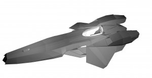

I need to clean up some stuff and create the interior of the drop-in cockpit but this one is do-able and has the landing-gear and I re-worked the rest of the mesh and it has been cleaned up to unfold. Going to take some careful work around the intake area and wing join but when is that ever NOT the case.. Who wants to unfold this beast? or at least help out?

This looks really good! I like the fact that you are doing the drop-in cockpit and landing gear! I am willing to do the test build and evaluation.
