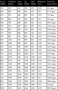

Here in the states, for most models, you will only need 67 lb. and 100 lb. cardstock. You can use paper used for frames, Micheal's Craft Stores gives me the stuff for free (go to the back where they do the Custom Framing, tell them what you need it for, offer a couple of bucks, they can't sell it, so they give you what they aren't using). Sometimes, since they can't use it, they throw it away, if that is the case, just ask them to hold it for you. I have around 20 lbs. of 1 mm stock, some of it 2' foot by 3' foot pieces! I use that for ship bulk heads. If I did not have that, I would probably use Balsa wood. No need to get too complicated, and it's always best to try and get the stuff free. :)
13,520
9,593
Just out of curiosity, what would cardstock, 110 lb. Card Stockread in "GSM" on that chart you provided? I have a package of 110 lb. card Stock from Staples, and it reads 199 g/m2
How does that relate to the chart you posted, as "GSM" appears nowhere on the packaging? I am asking with all sincerity, as you are light years ahead of me on this. It's probably obvious, which irks me the most, as I usually miss the obvious stuff. :)
GyverX
Jun 23, 2004
48
24
knoxville, TN
www.matrixlair.com
well is could be 1 of 2 possibilities. it really depends if it is text or cover stock.
110# or pound would be
Text = 162.8 gsm
Cover = 297.88 gsm
1lb. of Text paper = 1.48 gsm. multiply each pound of text by 1.48.
1 lb. of Cover paper = 2.708 gsm. multiply each pound of cover by 2.708.
Hope this helps
Shipscape
May 5, 2012
41
2
Piperton, TN
I may be wrong, but believe that gms stands for grams per meter squared....same as g/m2. The 110 lb stock must be index not cover which comes to 199 g/m2 or 199 gms.
