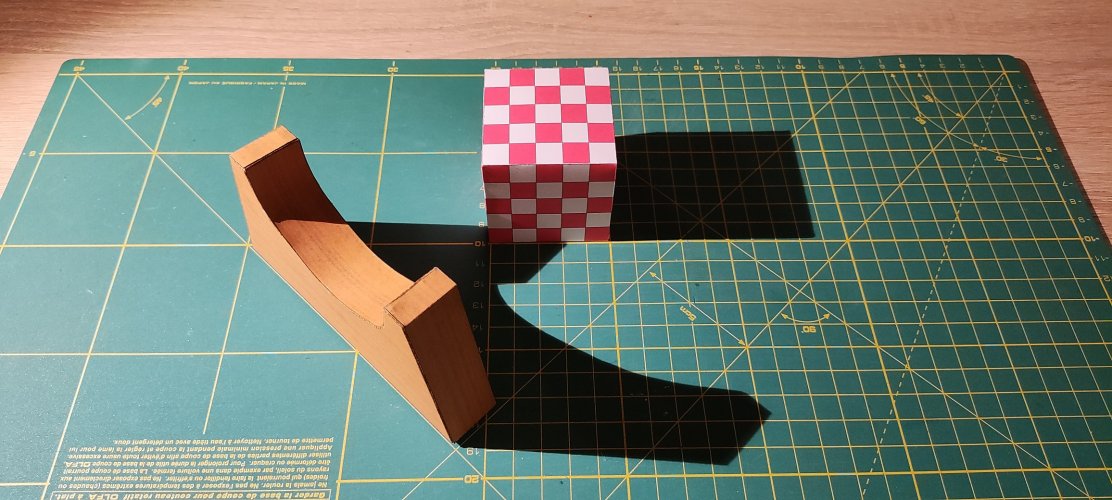

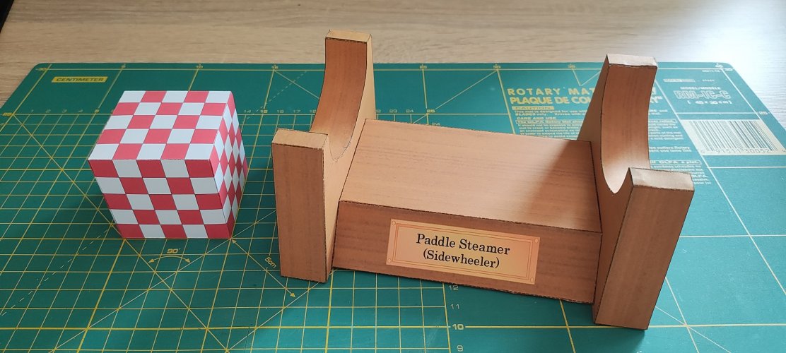

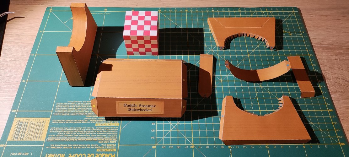

What better to start with, than the last point in the step-by-step guide... :)
Short session only, left wing of the base done, right one + center to go sometime tomorrow...
Completed wing edges colored with alcohol based marker, cut pieces not colored yet.
Scale cube in the middle is 5x5x5cm (approx. two inches).

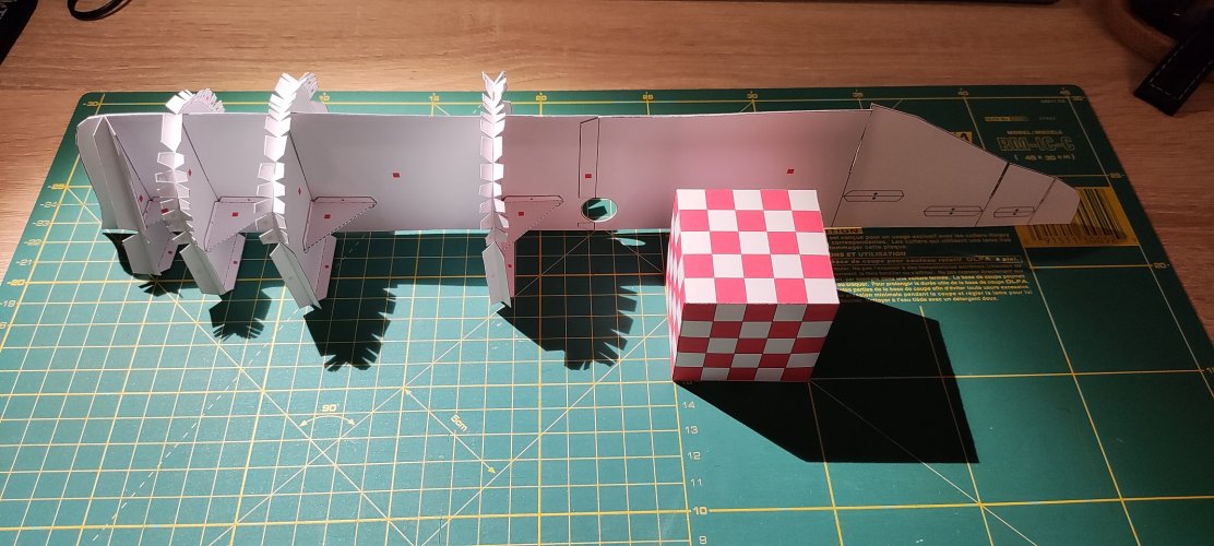

Finished the base (pattern cut from 3 whole pages in total).
Started first points of the instructions -> internal frame. It looks quite rigid and nicely thought through.
I do not have comparison/experience with other models yet though. S far the boring/not graphically pleasing part, but someone's gotta to the hard work :).
On the positive side, there is no need for edge coloring etc., as the whole frame will be covered with other pieces...
Inner frame on the picture is from approx. 3 pages, and one partial page of parts still to go.

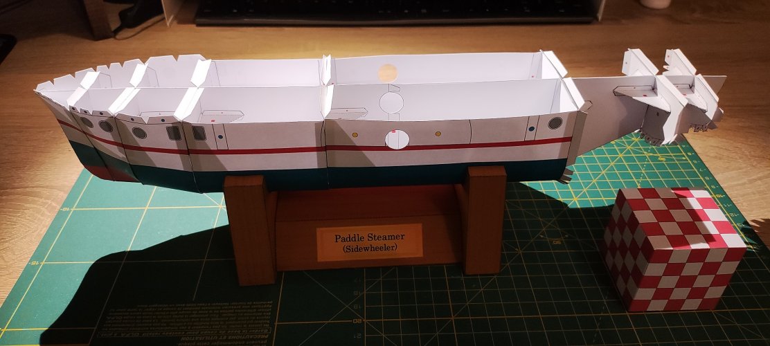

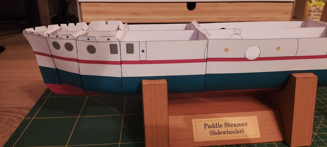

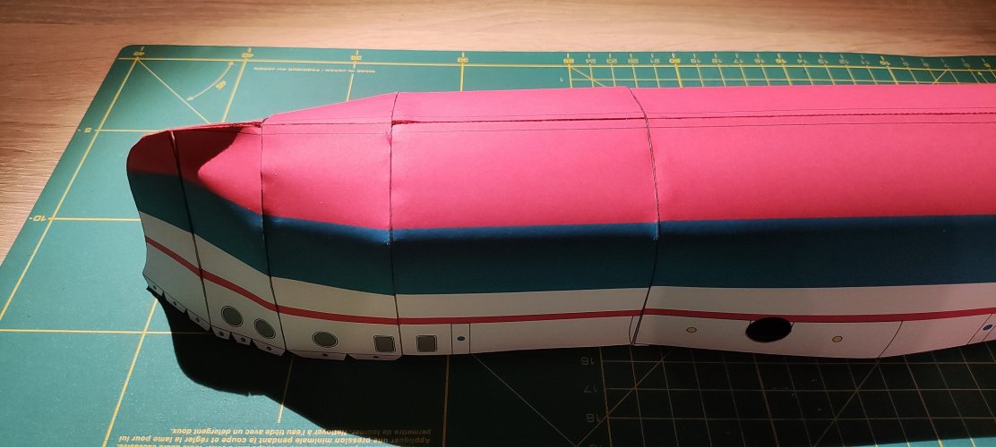

Time has come to bid farewell to straight joints, seamless lines, and similar advanced mumbo jumbo.
I keep telling myself i'm doing this for the experience, not beauty contest... :p
Some hull parts couldn't reach the edges they should due to tension of the braces.
Despite trying to go slow, some mm fractions add up and model apparently is not designed with eases for beginner builder and occasional offs.
Tomorrow time will hopefully allow me to finish the bottom part and start looking into deck/wheels.
I assume whole hull shape will look tiny bit better when remaining parts are added and deck + side wheels reinfoce the currently weak center part.

I think its the stressed look, and its where the hull has hit sandbanks - looks good bud
13,520
9,593
It looks good, you could always fill and paint the hull. When doing hulls, always start from the ends. The middle sections are easier to fit and compensate for. I always cut the black line out, and compensate with the framing. This prevents obtuse seam lines. If you're going to paint, you can use less paint trying to cover the black. :)
DaveTheCrafty
Aug 8, 2022
24
53
15
31
right, i was thinking about cutting off the black lines, but was afraid of how to compensate... do you mean you reduce/cut down the framing size as well? or add some strip on the hull to cover the summed up removed black lines...
