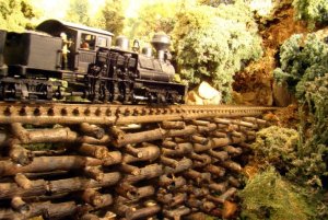

Hi Guys,
Thought I would jump in here on this interesting thread. Bill is correct I had a lot of problems keeping the Bachmann HO three truck Shay happy on my previous C&SRR. It started out OK but after a few weeks of work on a ruling 2% grade with tight curves( rarely down to 15" radius in three notorious spots) it just would not pull and would frequently derail. Close inspection showed the Delrin gears slipping on the lineshafts. Before long it would not even pull itself. A review of this problem all over the internet shows the same thing happening repeatedly to the gears and lineshafts. There has even been a very interesting discussion about the chemical composition of Delrin manufactured in China. That is why NWSL has stepped in to this niche market as there are a lot of pretty Bachmann three truckers out there that do not run well because of the slipping gears on the lineshafts. I basically was left using mine as a nice photo prop as in the picture below. It never functioned well enough to be in operating sessions on the old C&S RR.
Doc Tom:confused:
