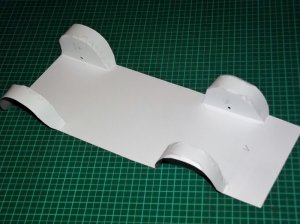

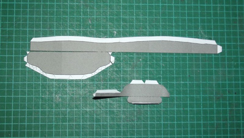

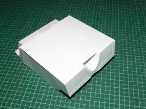

I started with the bottom of the car. Since the parts don't have any flaps I have added them myself.
I used a hole punch to make the holes into the parts. Maybe I'll be able to make the wheels rotatable, we'll see.
The floor will be strengthened with some card later.

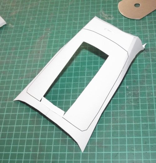

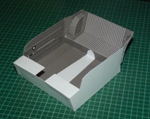

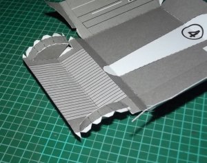

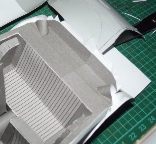

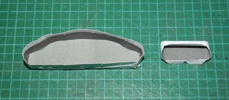

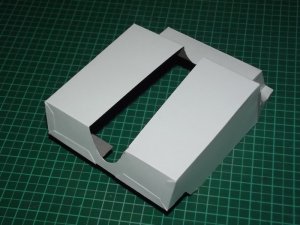

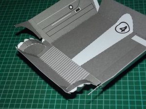

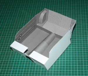

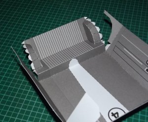

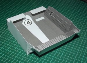

The interior takes shape. The cabin got some custom flaps as well.
The white piece in the middle will be cut out. To make sure that the part maintains its shape during folding and glueing I have left it in place for the time being. I only made the straight cuts along the sides.
Since the rendering in the instructions don't show the assembly clearly I have taken some additional pictures for reference.
Work carefully and tackle one flap at a time.

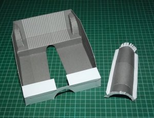

Now the time has come to cut out the white piece in the middle.

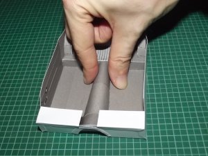

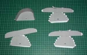

Two half cones are glued together:
11,671
12,450

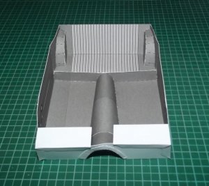

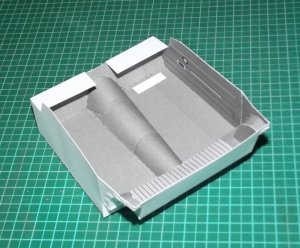

They are placed right inside the hole:
If you look closely you may see a bent in the rear area where the half tube was glued to the back side. Apparently I did not preshape the cones properly. To solve this mishap I took some scrap paper and glued it to the back side with regular glue.
Then I pressed the bottom against the cutting mat to level out the bottom till the glue had cured and the part was fixed in its intended position.
And DONE! :)
Another oddity aside from the missing flaps is that the designer chose to use the same dotted / slashed line for mountain and valley folds at the same time. Usually you would expect a slashed line to be a mountain fold and a slash-dotted line to be a valley fold. In this kit all lines look the same and it is very important to pay attention to the instructions and to test-fit the parts before glueing.

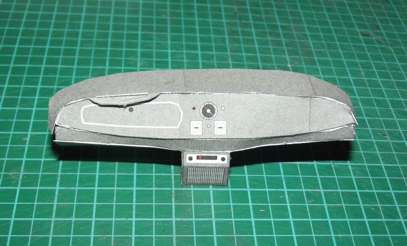

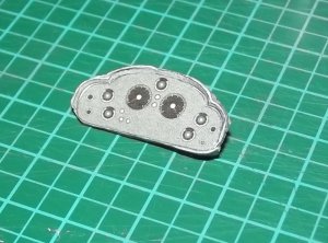

Next comes the dashboard. :)

Nice and squared, looks very good. I downloaded this model. It wouldn't be hard at all to make the doors open. I was surprised by how well it is done. Greeble the wheels, and the model will POP!! :)
Reactions: Revell-Fan
13,520
9,594
I'd print out another instrument panel, lay a sheet of plastic, and cut out the circles of one of the panels to give the gauges a recessed look. :)
11,671
12,450
I may consider doing that. :)

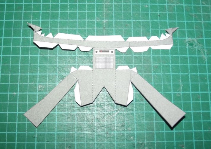

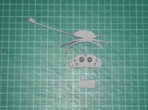

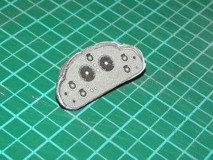

Let's continue with the dashboard.

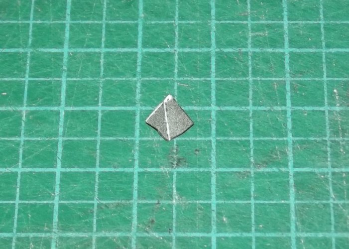

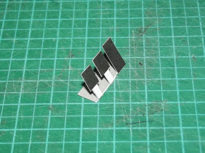

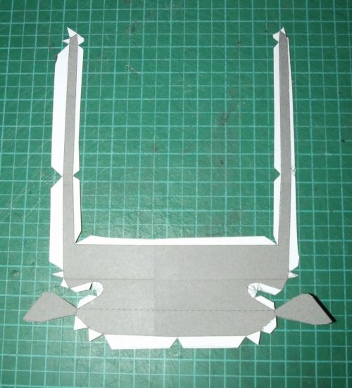

This is a very straight-forward component - aside from the little triangular pieces at the sides. To this day I was unable to find out where those appendages go, so I cut them off.

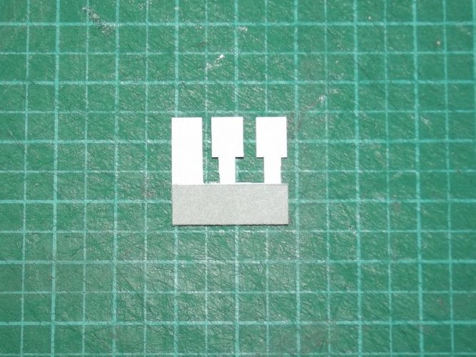

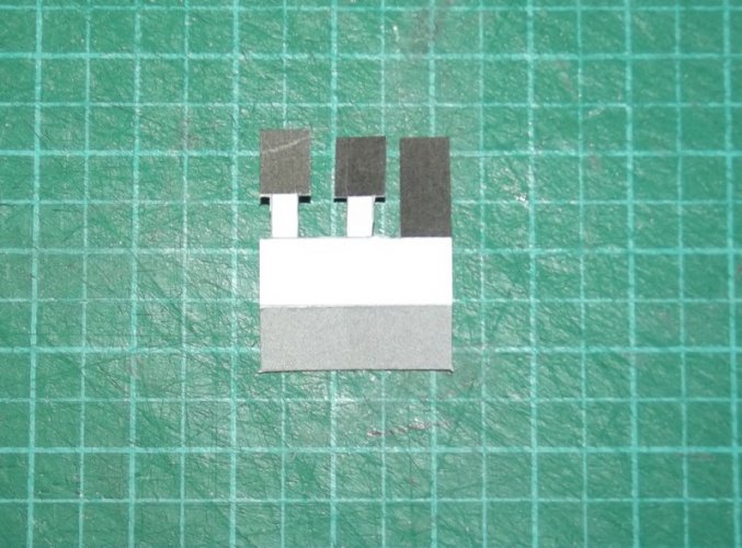

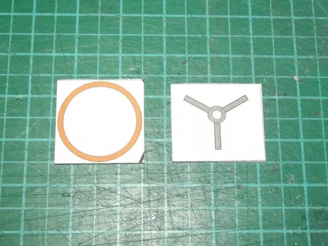

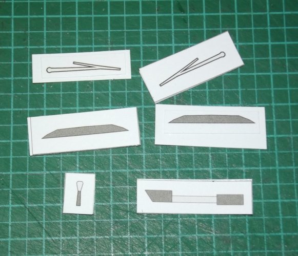

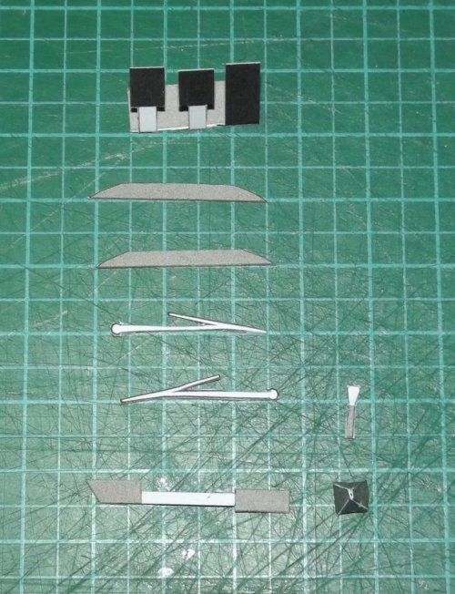

The steering wheel consists of two pieces which are laminated to another piece of paper, as are the pedals, wipers and levers:
The instructions leave the builder completely on his / her own with this part. First you fold up the grey rectangle and glue it to the back.
Then you fold up the pedals like this:
Since you will never see the back side it is not necessary to paint it.

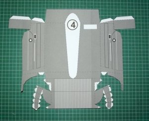

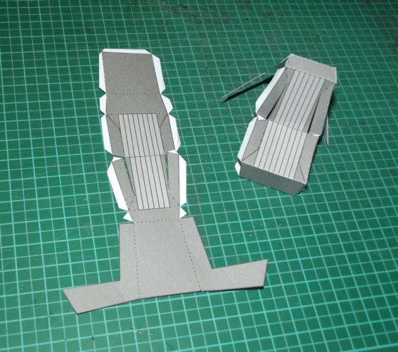

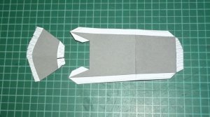

The seats are straight-forward. I added some flaps for convenience. ;)

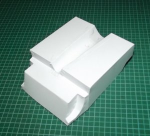

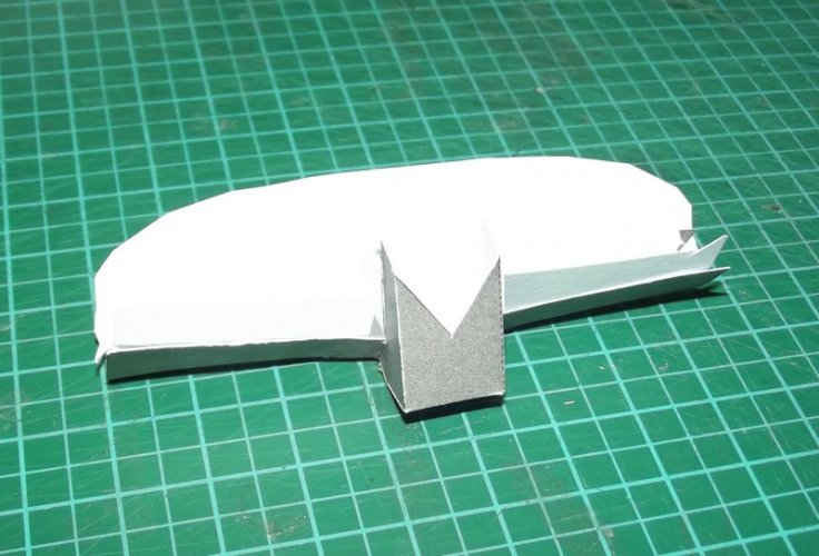

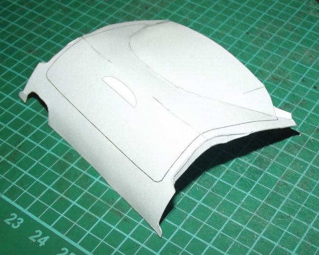

Then came part 15:
I had to spread it on two pages so there is a small seam. If it becomes too obvious on the finished model I'll cover it up.
However, thoses two little "ears" at the sides almost drove me nuts. The instuctions do not show clearly if they were folded into a convex or a concave shape. I decided to fold it up to a convex shape - which later proved to be correct.

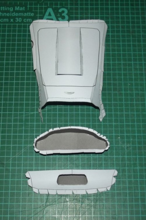

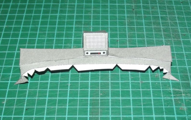

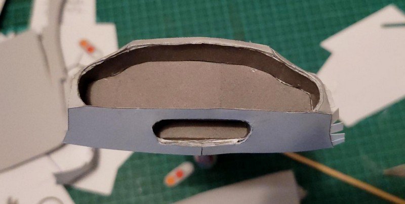

Next I tackled the grill section.
The recessed shapes are straight-forward:

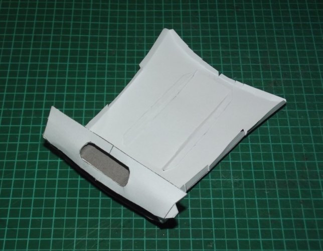

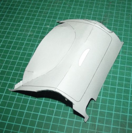

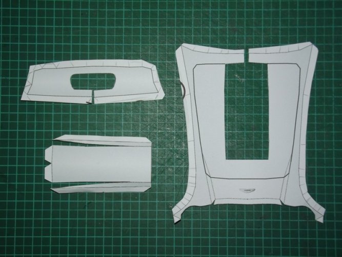

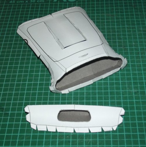

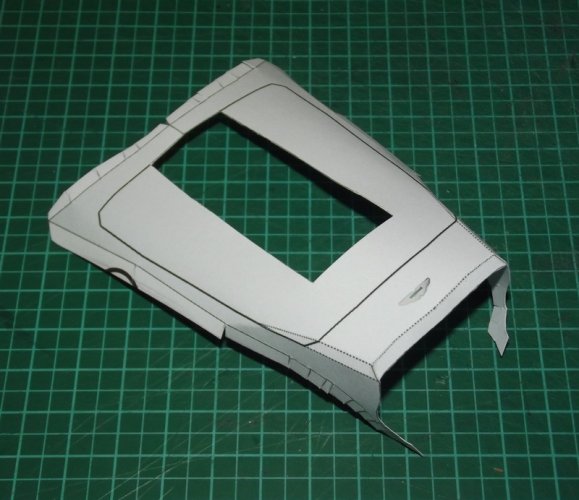

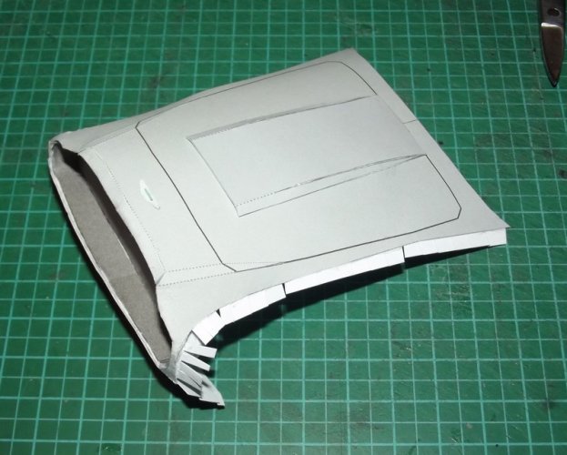

The parts for the hood got some additional flaps. Please note that this was the first version I printed to check the new colour.
So far so good. However, the next problem occured: The instructions do not clearly show if the small side of part 22 is up or down.
So I ended up attaching it with the longer side up which actually worked quite well:

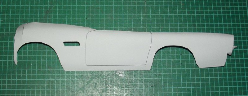

Then I realized that the new colour including the fancy gradient I chose did not look good on the model. So I printed the hood again, this time in a light grey.
However, after completing the second hood I noticed that the new shade was too light. So I printed another hood in a slightly darker grey. Fortunately that one was spot-on.

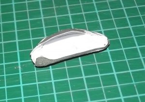

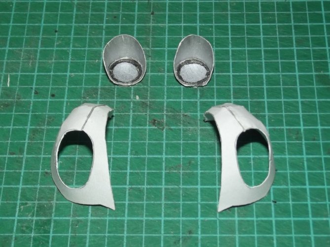

The front lights and covers. I painted the tube-shaped part of parts 27 with a silver marker which reflects the light nicely.

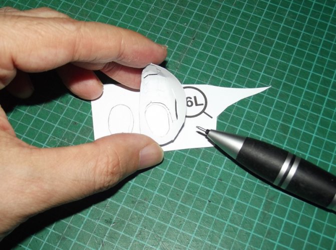

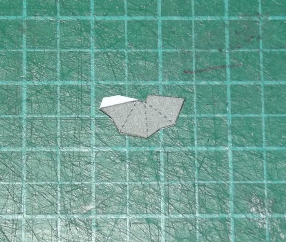

Then the instructions fooled me again. You cannot really tell where 27 ends and 28 begins. So when I saw that thick black ring on the outside of the cover I believed the lights were supposed to be cut out and layered behind some clear sheet. So I cut out the circles within the black rim, cut out some discs from clear sheet and then noticed that the creator meant to attach the clear sheet to the front of the cutouts of the covers (28), not to the lights themselves (27)!

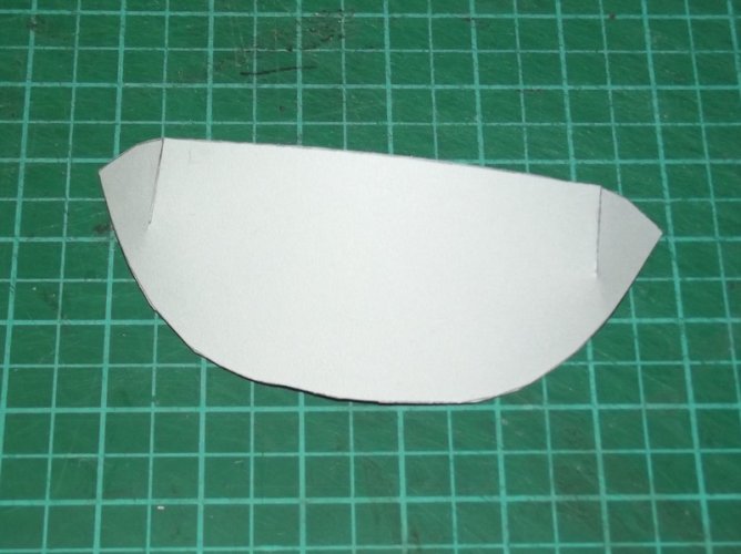

So I closed the holes in 27 with some leftover pieces of the other hoods and looked for a cutting pattern for the clear parts that should go onto 28. There are NONE.
So I had to make my own pattern by tracing the holes onto some paper and use these as templates. Since the covers are not attached to anything yet they are pretty flimsy and start changing their shape depending on how much pressure is applied and from where. So I have no idea if the templates work. More on that later when I get back to them.

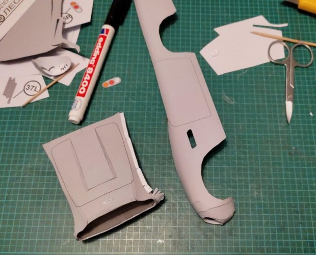

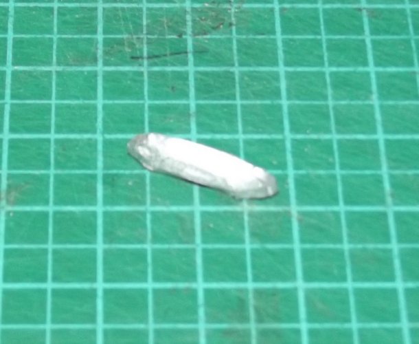

The handle of the trunk was also painted with the silver marker. It is very small, so please excuse the blurry picture.
Fortunately the other pieces of the trunk were straight-forward again (at least I thought they were...):
AND FOOLED AGAIN!
Parts 31 are not folded down but up. So I cut them off and attached them the other way round...
Now it is correct.

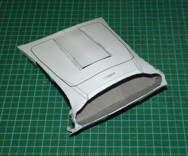

And the left side cut out and pre-shaped.
This is the state of today. The instructions are tough but once you have figured out how the parts go together they will produce a very fine model.
