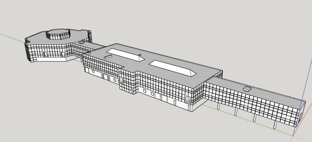

Well, after receiving the advice of several other 1:400 aircraft collectors I've decided to convert my project from a paper model design to 3D printing. So my task at this point is to go back through my 3D models and add in all the detail that would have been drawn on the paper, increase the depth a little further on the stuff that would have been built up by layering, and to design decal templates for the fine details.
This here is Concourse C, built in 1987. It was a fairly simple design for paper... then that all changed once the time came for me to go back in and mark it off every 5 feet and carve in the panel lines...
By the way, what's the best way to accentuate these lines on the finished model? The real ones were filled with a dark gray caulk. Should I use a paint or ink wash, or go over them with pencil lead, or some other technique I haven't thought of yet?

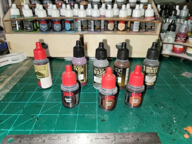

I like AV Vallejo model paints, and The Army Painter figure paints. both have washes and shades in many colors.

These are just the washes and shades that I keep in my paint racks.
Both manufacturers make many other washes and shades.

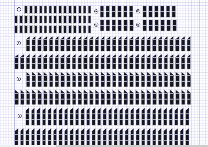

It's gettin' real, folks!!! Laying out the decal sheets in Inkscape, to export to raster PNG then print at 300 dpi. This A4 sheet (slightly larger than US letter) is nearly full... and this is just the windows for concourses A and D. I had no idea they would take up this much real estate... I had expected to fit everything onto a single sheet with plenty of room to spare.

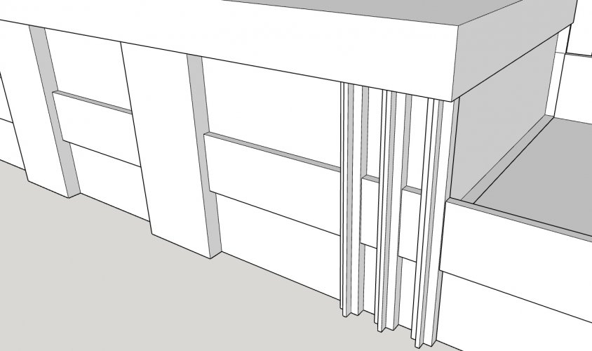

Shaping the front facade of the main terminal... increasing the depth of relief and carving out the groups of 3 T-section columns. This wouldn't have been possible to execute in paper, and all of this detail would have been drawn in.

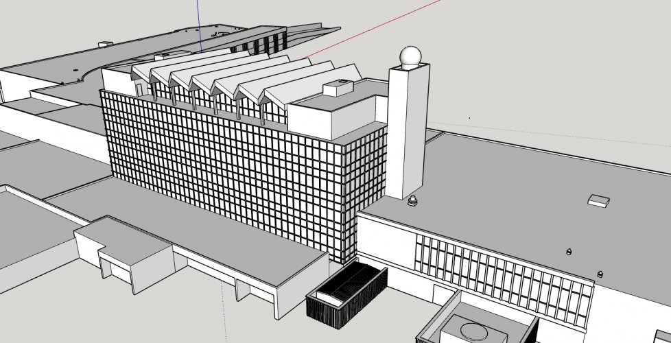

Adding detail to the main terminal. Here we are looking roughly east from a vantage point above the USAir ramp toward the Administration Building. The next area to be addressed is the postal docks in the center foreground.

By the way... how should I handle the two structures in the lower right corner of the screen? The air conditioning chiller and the corrugated metal shed structure. In real life, both were housed within an enclosure made of corrugated metal that was open at the top (apparently to improve the aesthetics for the public). I want to create the needed effect without creating deep narrow crevices that would be impossible to get paint into (remember these are 1:400 scale and the enclosure wall is within a foot of what's inside it, in some cases. My thought is to partially fill the space almost to the top and paint it the deepest, darkest flat black that I can possibly find, while painting the AC chiller itself a stainless steel/aluminum color. The fan on top of the unit will be represented by a decal. Do you all think this will work?

That would work, just a deep black. darker than NATO Black,
Do you have a specific product in mind? I'm going to need this same black on the facade and on the parking garage as well... and a grayish black to simulate a tar roof in a couple of spots. I really want to use Black 3.0 but at 30 bucks for 5 ounces, my wallet says no.
