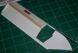

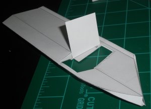

MORE DOORS
To add the support piece I had to cut it in half to clear the doors. I installed it the same as the starboard side but it was a bit trickier because the door hole made the side want to flex and bend.
I had to cut sections out of the center section on both sides of the doors to account for the new door frame I created. I also had to use my hobby knifes to shave away a section out of each craft stick support piece for the door frame to fit into. This allowed the side to attach flush at the centerline.
Reactions: Revell-Fan

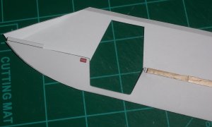

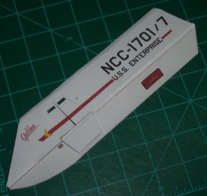

For the lower panels of the door frame I cut off the tabs and edge glued them to the inner hull skin. Since I didn’t use the original door parts, I had to plug the holes left on the upper door frame. After slightly closing the doors to make sure I had enough clearance I took some scrap matching color card and edge glued it into the frame. Then I used my precision scissors to trim off the excess. This worked well because it made sure the pieces fit the frame without having to deal is gaps or parts that don’t quite match up at gluing time.
I scrapped my my original plan to use magnets to open and close the doors. I couldn’t find any locally that would work and it started to seem over-engineered for this design. I settled on putting two very small holes at the door edges with my metal pick which lets me open and close the doors pretty easily. I put the holes in the red strip to help hide them. If I were doing another model I’d design it with a removable roof so I could see the interior and somehow open the doors from the inside.
I attached the door step using the original card flap and gluing it to the outside hull skin. This works OK, but I wish I’d been smart enough to come up with something better. As is, it leaves a bit of a gap toward the rear and I’m not sure how long the flap will hold up under repeated opening. With the door design I have I can position the doors so the edge of the step goes in slightly behind them when closed. That keeps the step up.
Lastly, I added raised details for the “Push” button and red panel on the hull. I also added a filler piece of scrap card to cover the centerline support. Then I added the wing.

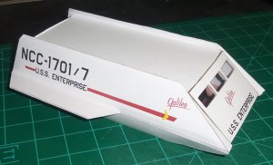

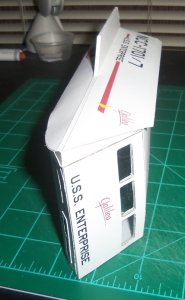

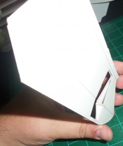

MORE ASSEMBLY
Time to attach the sides! Each side has a little outline that shows where the main body attaches. I did several test fits to check alignment. I put a line of paper craft gel glue right up to the edge of the outline and several lines of glue back and forth through the center. I paid close attention to how things lined up with the front section, especially since I still have to design a strip of the centerline. I think things are looking good so far. :)
On a side note, anyone else notice the design similarities between the Galileo and the Executive Shuttle from “ST IV” and “Generations?” Galileo always caught flack because the design wasn’t aerodynamic, but 20+ years later a similar design (scalloped edges, rear engine area, boxey shape, stubby wings) pops up. Funny how things come around. ;)
There are two ways to make the construction more stable: Either add some triangular supports to the bottom of the step to prevent it from sagging or cut a hole into the fuselage, push the step through it and glue it to the back side like I did with the opening tab of the Aurora hatch:

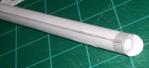

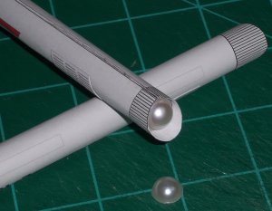

MORE NACELLES
Sorry for the long delayed update. Had a lot of warm weather home projects that had to be worked on. However, I have made some progress. Another trip to Hobby Lobby got me the perfect ends for my nacelles. These are 10mm half-round pearl beads from In Bloom. Cheap and easy fix!
