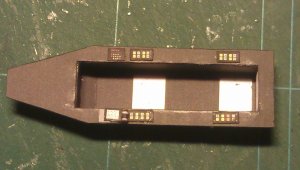

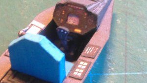

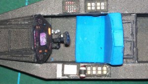

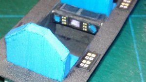

After the EXPO that I had attended recently, I had given my entire Thunder Fighter squadron (with the exception of the one that I built in memory of my mother) to the children of a member of the PM club that I belong to. I am now rebuilding my entire TF squadron with cockpit interiors, landing gear, and as much detail as I possibly can.
I will be posting photos of the detailed parts and explaining what all I am doing along the way.
I have started with the cockpit interior. I know that some (if not most) of the detail will not be seen once the model is finished, but I am doing this for my own pleasure (and torture sign1)
Here are the photos of what I have done so far:

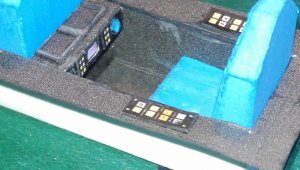

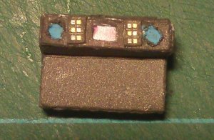

Here I recessed the sensor screen.

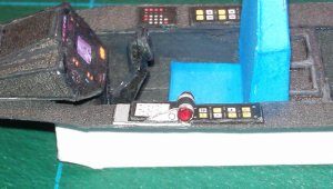

I recessed the screens and raised the button panels.
I recessed the screen.
Raised all button panels.

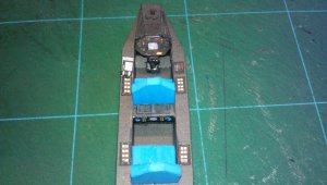

Added seats and some control panels.

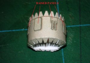

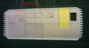

Update

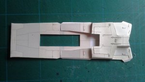

Here is an update on my progress of the project.

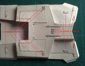

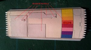

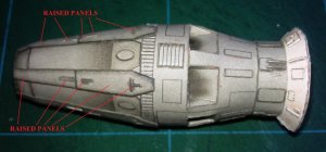

In this set of photos, all I really did was raise a few panels to give realistic texture to the model.
Here are the photos:
Reactions: spaceagent-9

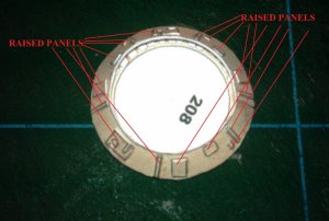

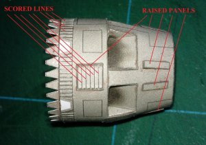

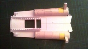

More photos
Here are more photos:

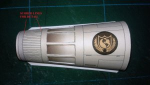

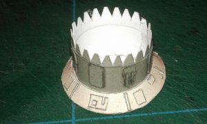

I scored the lines on the ribbed area that is on the front end of this piece.

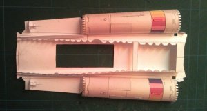

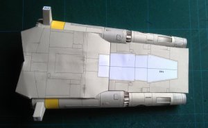

Both halves are now attached.

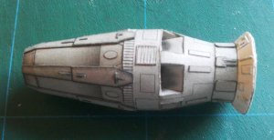

Cockpit interior now in place.

it looks great....i'm watching this from the beginning...
And there are many great things you do for getting that detail stand out..
i have a question..
you score some lines to get a more 3d view of the engine..etc..
but when you do that don't you get the paper to fold there?
i wanted to do that with my xwing hull....but was afraid that when bending the hull over the frame that it would folded..
how did you do the bending without folding?
12,579
9,993
i have a question..
First, Thank you for the compliment. The technique that I am using is a very easy one and (IMHO) it gets some of the best results without really doing much at all.
Second, to answer your question. Quite a bit depends on the part and where you want to score. The easiest and best way the "STRENGTHEN" the scored area (and keeping that area from bending or folding) is to laminate the back side of the part that you just scored with extra card stock. I hope that helps you.
