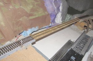

Jackson street street trackage
I gave been working on Jackson street.
I got more Rix 1930 overpass railings, which allowed me to finish the railings.
The railing's bas stuck up a little from the styrene street, and I wanted that to be close to flush, and I wanted to bring the street level up to close to the level of the code 83 rails on the peco flex used for the trolley tracks. I had found some midwest foam from hobby lobby I had on hand. I glued it down, after carefully cutting sections to size, with Leech f -26 , a contact glue in a tube. I had to spread it thin, and let it get most of the way dry before I applied the foam or the foam would melt a little. I have a section of the pavement that is cut out, where the Union Station can fit in
I have started to fill in between the pavement and the outside of the rail, using vinyl spackling ( note to self, mask the railings before getting out the vinyl spackling ) . I'm going to try to use plastic brick sheeting between the rails. I'll have to see if that works, and try something else if it doesn't
