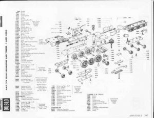

My wife bought one for about $100 at the NMRA convention a few years ago. I spent another 25 having it looked at by our local expert.
It has an odd design: the motor is part of the frame casting - the armature and worm ar mounted vertically. The brushed go through the frame -- one is grounded by the mounting, the other is insulated.
There is an adjustable bearing at the top of the motor that can be turned by a screw driver; don't do anything to this unless you need to.
There is a small ball bearing (single ball) at the bottom of the worm shaft -- this was missing on mine and the commutator was a little low for the brushes.
I think I have an exploded diagram somewhere.

Exploded diagram
Mike: I'll try to attach the diagram, if it's still readable after the compression.
This is the HD sheet and covers two and three-rail versions.
(If no good, PM me and I'll send a larger version)
