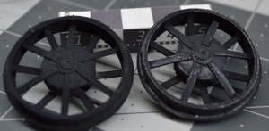

First off wheels.. front to be exact... I have no idea how many but there's a bunch of tiny < less than 1mm bolt heads on these things!! Tend to vanish a bit under a coat of flat black..but should pop back with some weathering!
Left one bare flat black, Right burnished on sections no weathering yet!

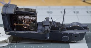

next up..parts on the engine.. putting a fan belt on this was a bit tricky.. but not to bad.. since once I fire the motor it will rip anyway!
a sized strip of card... well burnished and rubbed and colored with a black sharpie..and sanded lightly with 900 grit... glued at the bottom,, brought around to meet itself, marked, cut, and glued at the bottom! Added in the starter crank as it was time to do so!

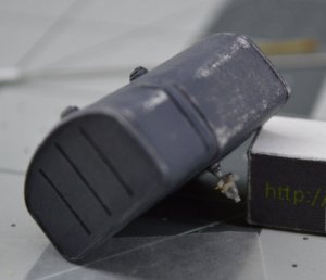

Double tanks, end joined and filler caps... and started with the plumbing, ie: fuel filter, by using a small piece of clear sprue, from an old plastic kit, and fine sanding to shape. was going to use very fine wire casing for the fuel lines, but the smallest I could find ( ribbon cable from an old PC) looked like a firehose, so had to switch to some .3mm copper wire and weather it later ( if I can find it that is), about the size of a human hair to my eyes!

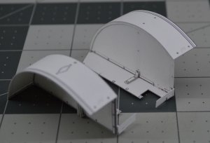

Worked on the rear fender assembly, that is cut and glued it! Still, have to add it the bolt heads and such.

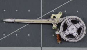

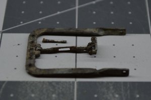

Here is the brake arm assembly... This was just a bit rough to get together, as I pinned the parts with wire, so it ( if it were a brake assembly ) actually work, which just made more work, and took way more time than I had thought... Pick of it newly made, some parts reprinted in a thinner card as my regular was too thick.
and with some paint slapped on!

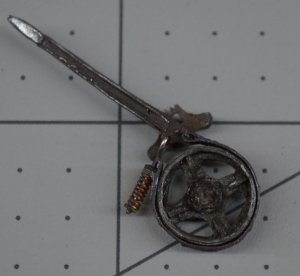

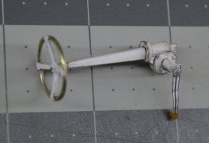

I made up the steering column but had to change the size of the wire rod, as it was a bit too short to clear the rear finder in its original size ( as shown here) and before you ask this one does not drive the front wheels, way too small to gear up! With younger eyes and steadier hands, IT COULD, just in a size I was not going to deal with!
The wheel is made with 1 mm vinal covered copper wire, rolled into the circle and I will see if a fine round file will add the finger grooves on the back side before a paint job!

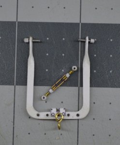

Here are the rear hitch and turnbuckle, for towing (maybe a hint there) or farm work. Turnbuckle gave me a bit of clutz-finger as I had a very hard time getting the parts aligned to glue up.

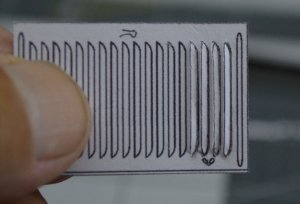

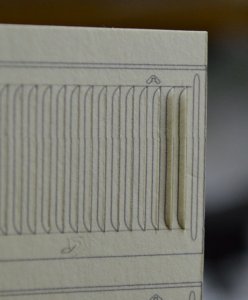

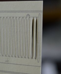

I gave up on using the brass on the side louvers, just to small and hard to cut slots, for me anyway. So tried the original which takes a cutout, and replaces it with a glued-in louver. It was just too messy, and the back looks like a botched job, so I re-printed and used my old tried and true method of a single slot, then burnish and form the louvers with a burnishing tool. Not as rigid as the glue-in method, but a far better louver to look at!
Original...
My modified version...
and the other direction... very clean and REAL, as that is how they are made, to begin with!

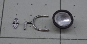

Headlights have a story all there own!
I'll mention the bracket, shortly. I am going to replace the lens and trim ring, just too bulky and thick. Not sure how as yet, hand-cut trim ring this small, is going to be a problem, no matter what. When I figure it out, I'll share it!
The metal bracket, in its original form, was the curved part and then straight sections CV glued on! There was no part to fix to the mounting bracket, and the whole thing was flimsy!
So, I took the wire bent the curved part, then added the 90 degree part, and figured solder was the way to go! I was right, the problem turned up in the form of magnetized wire! Every tried to solder two pieces of very tiny wire together and find it attach itself to the iron? What a pain! Took the better part of an hour to align, solder, remove from iron and try to re-align before the solder solidified! There is an old saying, about a monkey and a football, enough said!

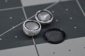

Like I said somewhere in this, I had to change out the headlamp lens, and while taking a break from fuel / electrical lines, worked on that!
Getting to the point that my camera is having a hard time getting into focus.
Still, need to finish the forming and sanding on these, but reflector and lens are in the new rings, that I ended up cutting by hand.

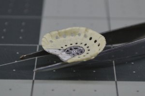

Work started on the tractor seat, needs some more and a trim wire around the edge to give it the rolled effect. Sanding? I have to build a 3/4 inch sander first! ;)

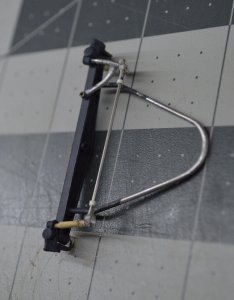

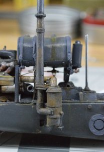

oops... I got into building the snorkel and while assembling, had to paint parts... and next thing I know... it was finished... Sorry... but I will say this it was created using the paper roll from cotton swabs, wrapped with typing paper for the thickness, built on a .5mm wire lots of cursing and trying to find the fiddly bits I kept on dropping. There is a U bracket still around here somewhere but it TOTALY disappeared after being dropped for the umpteen time! Someone will find it someday, but I looked for 2 hrs and still didn't find it!
NOT glued in as there are far too many parts to add beforehand!
If someone REALLY wants to know HOW I built this ... I can do a small tutorial ... just have to ask for it!
