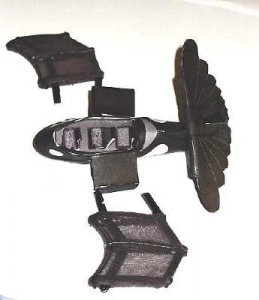

Here is how the WIG with foldable wing is going. The wings are getting better but slowly. I'm back to the smaller scale and am now using the cardstock wing ribs instead styrene supports for the front to back part of the wing support. I've thickened the ribs to 8 ply to get the stiffness and adding an edge strip that covers the hinge wire. The wire is now fixed within the rib so it doesn't rub against the paper and tear it. The rotation of the hinge is between styrene and metal. It no longer has metal rubbing against paper or fabric.
The wing has been blackened with a Sharpie. I'm working on the stretchable skin out of nylon socks. I tried laundry starch to stablize it, so I could use a sewing machine. It worked so so. I've now bought water soluble stablizing paper that is normally used for quilting and embroidery. It can be run through a printer. You pin the fabric to the paper, sew through both and then dissolve the paper with water. I'll let you know how it works on my next interation.

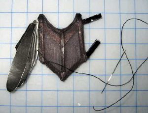

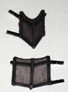

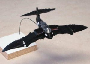

Here it is with the wing skin. The skin is nylon trouser socks cut up into 2.5 " x 2.5" squares and sewn with quilter's monofiliment. I usedlaundry starch as a stabilizer to so I can get it through the sewing machine without bunching up. If you can see black thread on the leading edge it's nylon beading thread. I put it on to try to keep the leading edge from collapsing.
I did this before discovering the soluble stabilizing paper.

Hey Lizzie,
It's looking pretty good. Show us a picture with the wings folded and the material attached. Does it bunch up?
Also the body looks like a one piece fiberglass molding...........it is paper? right?
What did you use to cover the joints?
john

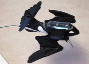

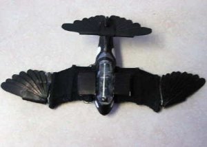

Here are the wings with one folded and the other mostly extended. The fabric sort of shears so it stetches across one diagonal and compresses along the other.
The wing struts stop it from folding smaller. On my next interation I'm going to make it fold smaller.
I'm pleased with how the idea is working out. It seems that I am following up on some things that the Wright brothers did by having wing shape change instead of using flaps.

Looks great! Wing warping is the acutal term and it worked enough for them, if I remember correctly your craft has AI so I'm guessing it does the warping with out much pilot input.
Did you use a filler on the seam edges? The curves look very smooth!

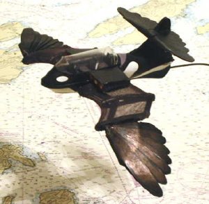

Here are what I call the pinion fans as they go together. On the top I have one partly done. I still need to sew it to the wing rib, blackened the white edges, and put something over the exposed hinge wire.
Below is the parts of the second pinion fan laid out. Each pinion plate is made of and inner and outer sleave. The outer sleave folds left to right and the inner sleave top to bottom. When sewn together like a window shade, each plate slides inside the larger one next to it.
I guess I should show it folded as well so you can see how one goes plate goes into the other.

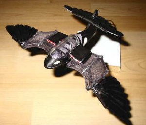

Here she is, prototype number 15 or 16 or 20. I've forgotten how many I've made.
It's finally getting better. Maybe two or three more builds so do it. The wings need more tweaking so they close further. The propulsors are attached as securely as I'd like, and there is still some messyness on the the fit of the skin.
The next build gets people in the cockpit.
Oh yes and I'd like hydro foil landing gear. Hm maybe five more prototypes.

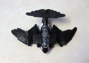

version 21
Here is the next build of the same model design. On this one the wings are rigged so that I can trim them. Pulling one set of thread brings the wings in and the other set holds them out.
I'm still not content with this version. You can see the gap between between the wing bodies and the pinion fans. The figures inside the cockpit are too flat and they don't fit right. I'm redesigning to lower the seats in the cockpit. The canopy still looks clunky and so do the propulsors. The wing skin is too loose and now that I can hold them out I see that the wings are too long for this type of craft.
Here are pictures of the wings out and in and one with them in while up on a stand. You might be able to see the trim threads. I'm still working on a way to tuck them out of sight. Shortening them a bit may be all they need.
I can't photograph it out on the Inlet today because it's snowing and I don't want to have big gloppy snowflakes in the picture.
