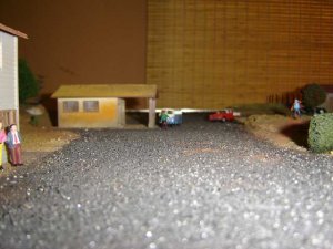

I use a mixture of sand blasting grit- can also be used for model coal, matt black powder paint and plaster(in powder form). Ratio: 2 (Sandblasting grit) : 1 (Matt black powder paint) : 1 (plaster).
This gives me satisfactory results.
Will post at a later date, as soon as I get pics.

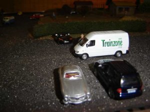

Long overdue thanks
HI all,
Thanks for all the great suggestions and photos. Have been sick last while so delay in responding. Better now and want to get back into it.
With thanks,
Heath:thumb:

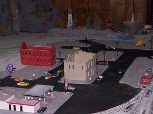

well i used
Heath said:
Hi all,
Was just wondering what you all are using for making road's/street's/highway's?
Store bought "rolls" of street's with highway divider lines, etc. or use other material? Wood, plastic?
Heard a few people mention about using styrene, paint it, weather it.
In addition, what about sidewalks & curbs?
Any suggestions?
Help would be greatly appreciated.
Heath
Hey Heath, I used a sheet of foam art board as a base and cork board for where my buildings set with enuff space for a side walk. I covered the cork board premixed wall plaster mixed to a gray color when dryed i sanded smooth never losing the color of concrete it made drive entries easy to make realistic. I just paint the roads with black paint and planning on using auto pin stripe for my street lines. Pin stripe for the curbs too.
