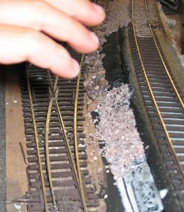

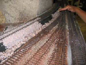

I did get some Arizona "Pink Lady" ballast, both the fine and mainline. It looked a little too buff or tan for what I was looking for.
Then I realized the granite on the tracks around here all comes from the New Ulm quarry - just 20 miles away. I made a trip and got boat loads of free "samples" - 50 pounds of bagged grit for poultry (rip rap in HO scale) and then was taken to a waste pile that was all purple dust mixed with rock fragments just the right size and the exact color I was looking for originally. I filled a few buckets and brought that home too. I had to sift the sand/small rock mix but had lots of help from my kids. In about an hour, I nearly 2 1/2 gallons of just what I was looking for.
The folks at AZ Rock were extremely helpful and friendly but I just plain lucked out. I would have spent over $300 ballasting the yard and double mainline had I stuck to that supply chain at retail cost.
I'll post some pics so you see for yourself . . .
