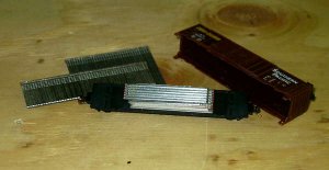

Dunno if this is a new tip or not, but I found a easy way of getting the weights that I needed for N gauge. I have an air brad tacker and so I also have a supply of #18 and #16 brads that are in sticks. I bough a very inexpensive digital mail scale at Wal-Mart for around $20 that gives me weght in tenths of an ounce. I weighed the cars, and then cut off a group of brads and added them to the scale. I could vary the size to fit the car and the wight I needed to add, but usually an inch to an 1 1/2" brad would work. I could cut off brads until I got to the ideal weight then double back tape them to the inside of the car. Since they are flat and stuck together, I usually only had to add one or two groups to get the weight I needed.
One thing I did find was that the cheaper the car, the more weight I had to add. I used the same forumla that Ngauger listed here.
Since this explaination may be a bit unclear, I've attached a picture of what I'm talking about. If this turns out to be an old trick, forgive me, I'm kinda new here :D :D :D :D

Don,this may or may not be an old trick.Never the less it will be new to the newbie modeler so still rates being posted.:)

Well, what I'm calling an air brad tacker is probably more correctly called an air brad (or nail) gun since they shoot brads, or headless nails and require an air compressor to work. I have a couple of sizes and use them in my woodworking for..... tacking two pices of wood together. :)
You can find the packs of brads at the Home Depot tool dept. or any tool store that has air tools. They come in sticks of 50 inside boxes of 1000. They are just held together with glue so they break apart easily. As you can see, they're flat and have no heads to get in the way.
Sorry for the misnomer, but the place that I bought mine used that nomenclature in their ads and on the boxes and it kinda stuck with me. :D

No, for N scale, that's .5 oz plus .15 oz per inch. So if you could find a 1" car it should weigh in at .65 oz. A 4" car would be1.1 oz
David,
On a N scale, I could get four or five glued-together nails across a car. If you look at the picture, I have a strips of 1 1/2" and 1" brads as they come glued together. On say an Atlas car I only needed a few nails, like a strip of four, on a Bachman or LL I sometimes had to add two or three strips (up to like 12-14 nails total), 1 1/2" long to get to the ideal weight. I sandwiched these strips with double-backed foam tape which basically added no weight. A few cars I had to go down to a 1" long size because longer ones wouldn't fit inside the car.
