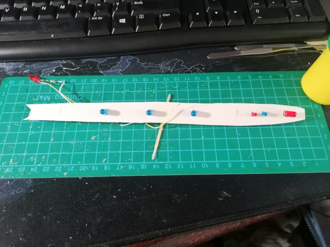

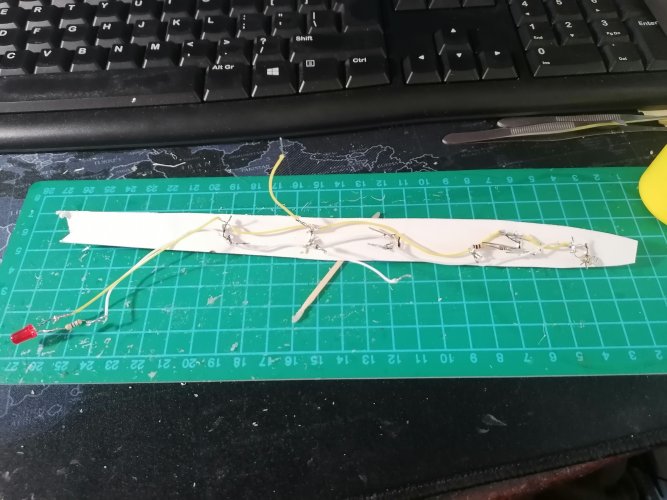

A tutorial, with a list of the online circuit makers would be most interesting. I seriously would consider to start using copper traces in your models, and solder the short wires of the copper trace main bus lines. The series-parallel circuits you could make, hidden on of switches, would be limited only by your imagination. You use epoxy to glue the copper traces to the paper and conductive epoxy to glue the wire to the traces, then solder the wires to the LED to the LEDs. :)

Guess I'm doing the thread then ;) @zathros , I have a but if a financial constraint at the moment so I am cannibalising old PC (USB, printer) cables so I don't know if will be able to do the tracers, but switches definitely are an option!

Thin computer ribbon wire connected to LEDs works well.
Also, guitar strings make excellent supports for where you cut the paper supports for LED wiring pathways.
Great Work you got going on!

OH, neat ideas. I bought a reel of magnet wire (lacquer insulated stuff) for wiring LEDs in buildings. Then of course, I immediately found a solenoid coil I had saved for the same thing. Sigh. And, I have a roll of copper tape made for edging stained glass pieces (another hobby) that would be easy to split and form concealed wiring.

I used to make traces by stripping lampshade cord, and pressing it flat, then gluing it to paper, or whatever it was I was building. The glue insulated it, and I left the ends open to solder onto. For heavier traces, I used pieces of telephone wire I'd mooch off of company trucks (much harder to do these days) but you can make some heavy duty traces that way. A metal dowel will flatten them easily. I did this when making projects in electronics school, hiding some traces under paint, and the other students could never figure out the simple test boxes I made worked. :)
