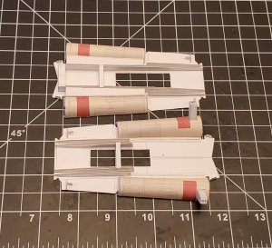

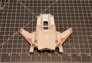

I have moved on to the body's internal formers and supports. Now, with this, I decided to take a page from the notebook of a friend (and fellow member) @silveroxide (who when he built his TF, he laminated the formers to add additional strength). Now, I know that I really do not need the added strength in this model (mostly because of its size and scale). However, I figured, since I am building it, that I would give it a go and see just how it will work out. All of the formers were laminated to (roughly) 1mm thick (I used the cardboard from old cereal boxes).

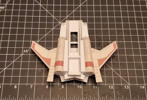

The formers are in place.
The rear engine skins were attached.

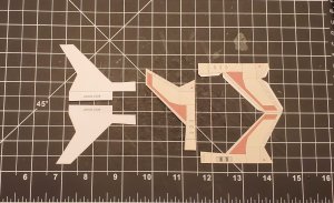

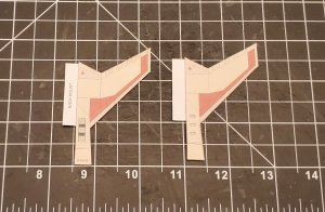

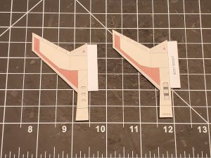

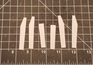

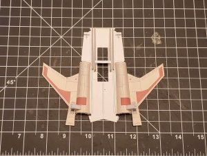

Here are the wings. Now, unlike the original (i.e. the main one/two seat, HBB and quad) version (where the wings are just placed on the sides to cover the seam of the rear section of the engines), these forward swept wings (FSW) have an internal former/mounting piece. I laminated standard cardstock on both sides so that the mounting piece is more "centered". I have also recessed the vents and the three ovals that are on either side of the back end of the wings.
The internal former/mounting pieces are in the wings.

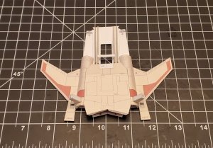

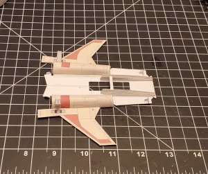

The wings are in place.
*NOTE* Please pay special attention to the instructions when putting the wings in place.

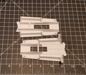

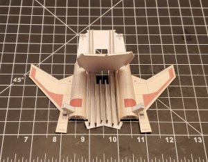

These are the internal formers for the lower rear section. Normally, there are only three pieces. I have split each in half and laminated them to (roughly) 1mm. This will give added support to the lower rear section.
The formers are in place. You should attach the front end of the rear bottom panel (part 247) before placing the formers. Otherwise, the panel tabs will not sit right.
If you look closely, I have placed two of the longer formers just on either side of the hole for the cockpit tub.
The rear bottom panel is secured.
Both the top body half and the bottom body half are attached.

It always amuses me to look at the two halves lying next to each other on the cutting mat. It looks like you were assembling two models, but then shortly thereafter the halves are combined and form (only) ONE fuselage ;)

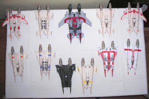

It is funny that you mention how many TFs I have built over time. Here is a photo of the collection that I had when I was in Eastern Europe. With the exception of the back center (which is a scratch build), all of these were test builds.
Awesome! I love the back center one. What's the story being that one? Is that the one you built for your Mom?
Actually, the one that is front and second to the right was the one that I made for my mum. The back center one was a scratch build that I did to see what it would look like if I put forward swept wings on it. after I had built it, @Revell-Fan suggested that we make an "add-on" kit of it for the @Martin Saenger kit (hence the MK-III (FSW) version).
