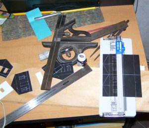

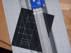

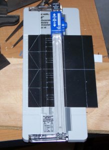

announce1 I think I have have discovered the wheel again:D might not be the first modeler to stumble on this but in doing the #1 challange cutting the styreen sheets was not going well . the other night at chat Catt and i talked about using a rotary paper cutter for scoring the sheets before snaping them went to Staples and got one so far it works great you can line up scribe lines with the edge of the cutter and two or three passes works well .I got the 6" one would recomended a 12" one ,can't score sheets the long way with the 6" one.

Yeah, now you tell us. I wish I had that a couple of weeks ago. Holding a ruler while trying to scribe a line with a knife isn't alway accurate, or fun... I'm going to check Michael's out, they ran a "40% off one item" coupon in the paper yesterday.
Thanks Jim, this is a great tip...:thumb:

Don the one Michael's has is not a rotary and it is higher priced , i got mine at Staples you might also try office Max.:wave: .With the one i got I have been able to make .035 cuts off the end of .040 styrene thin stuff like .010 cuts clean with 2 passes.

88 the thickest i can do on this one is .060.
