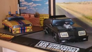

I then sprayed the whole model with 5 coats of gloss varnish. And once this was dry, I attached all the small detail parts. In the drying period, I made up the supplied display base. I found a picture on Google that I used as a backdrop picture and made a frame for it out of firm black card.
So, here are a few pics of the completed car. In my next post, I'll post some pics of the completed model on its base.

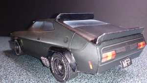

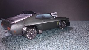

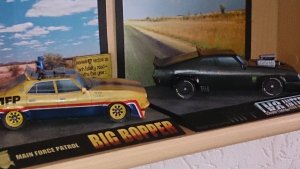

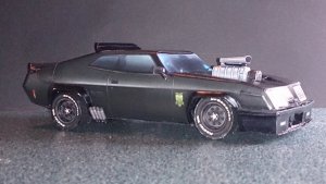

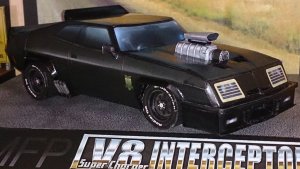

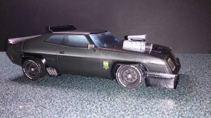

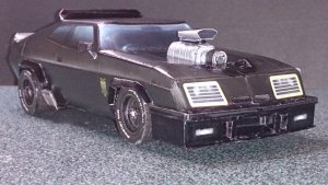

After what seems an age, the second quartern of this project is at last complete.
So, without further ado, my I present the finished Ford Falcon V8 Super Charged Interceptor.
DSC_0445.JPG DSC_0425.JPG DSC_0417.JPG DSC_0415.JPG DSC_0412.JPG DSC_0408.JPG DSC_0406.JPG DSC_0405.JPG DSC_0402.JPG

I'm totally blown away by these pics! At first I believed they were shots of the real cars taken from a catalogue. GREAT JOB, Dan!
