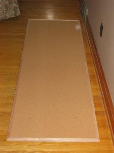

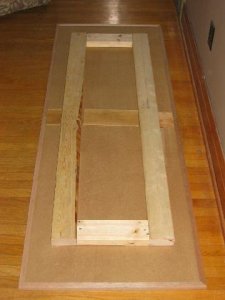

Too late with the advice Bama, just before you posted, I had purchased 2'x3' pieces of cork bulletin boards. I can see how water and moisture could be a problem, but these boards are constructed of 1/4" particle board with cork glued over top. At least it isn't cardboard, and it's fairy rigid. I suppose I'll just have to be very careful with water getting on the layout as I build.

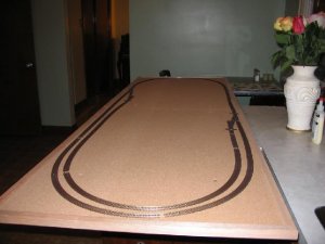

After trimming, I put the butt ends together and screwed it all down to a quick little frame that I built. Here's how it looks. This is just a test fit before I glue the track down.
