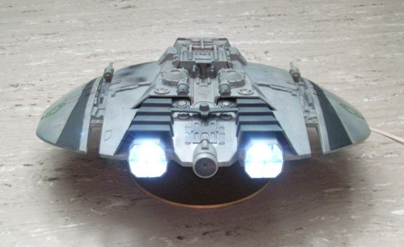

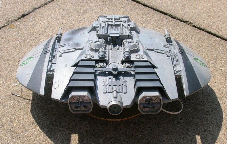

The black indeed absorbs the light, so it is best to use some bright colour inside and black on the outside to block the light. In the plamo business the builder spray-paints the inside of the model black and then applies a layer of white or silver to increase the blocking and create a reflective layer. The metal pigments in the metallic paint should block the light even more effectively because they are more opaque. If you use aluminium foil be careful not to let the wires of the LEDs touch the foil or you will end up with a short.
On my Cylon Raider I only used aluminium foil on the engines. This was a very crude construction. The LEDs were installed diectly inside the thruster, no lightbox needed. The foil was glued to the back of the thruster tube for additional reflection. They are EXTREMELY bright as you can see. ;)
