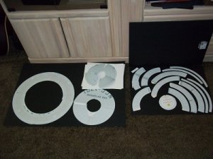

Choosing how to set up black foam cutting on RonC's big 1701. my idea is to thicken up the pieces by gluing them to black foam board-and poster sheets for the window parts. I don't know how to cut foam board. Any ideas? I guess I will use a Exacto knife or box cutter?

Cut with a Click Knife if you got one... then you can extend the blade to cut deeper...as soon as you cut through the first side the knife will go through the foam like it isn't there and you will poke through the backside...You also need a really sharp blade ( new x-acto) if not it might drag the foam and end up pulling out chunks...a Box Cutter Blade is just too wide for a good cut...and may collapse the edges of the skin. Also...it takes very little pressure to collapse and put a dimple in it...so if your cutting straight edges..add a strip of masking tape to the back of your straight-edge, helps stopping it from slipping.

Must foam board is a foam layer sandwiched by two sheets of paper, I use a self healing cutting mat for all my projects, that way the blade can pass thru the piece being cut, and glide on or thru the mat surface. If you have a free curve, or French Curve set, use them to guide the blade on the curved cuts. Otherwise just go slow and easy on the curves.

I thought about making my own cardboard stencils, and using those on the foam cuts. thanks, i might actually go get a french curvey plastic thing like we used in school! that is a good idea on the sticky mat! that will hold the foam still while I cut.
