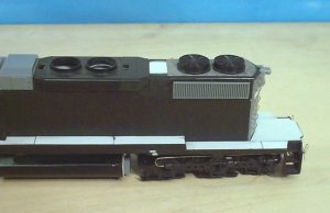

TiVo,

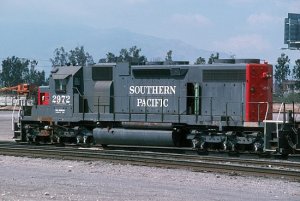

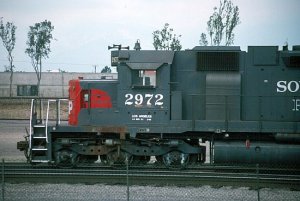

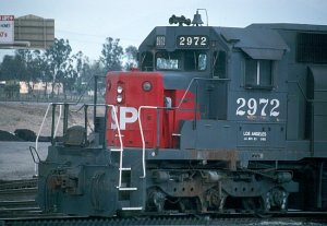

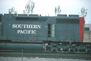

I would like to see some in-progress shots. I thought I'd share some of my in-progress shot of a GATX SD38-2.
Frist a shot of the prototype.
DanRaitz
May 30, 2002
300
Maricopa, AZ, USA

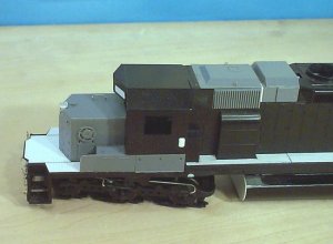

and now some shots in a work in progress. I started with an Athearn SD40-2 an replaced the radiator, nose, cab, cab-subbase, inertial air filter and paper air filter with Cannon parts. All the light gray parts are Cannon, the cab is one of Cannon's early runs before gray plastic.

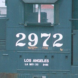

Dan,
Thanks for the images. Special that 2972 is one of the units chosen for the project along with 2974. Is there a higher resolution version of the first image? The shadowy reversed LOS ANGELES assignment and model number on the cab is one item that just begs to be modeled.
