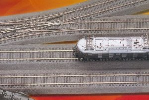

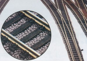

As Arlaghan has suggested, you can use track with built-in roadbed. In Germany you surely will find easily Fleischmann-Profi track or Roco-Line track.
The Roco-Line track have a detachable ballast that is very prototypical, and you can hide the switch motors under it. It accepts well to be painted, too. In the minus side, you will need to have well planned your layout, because this prototypical ballast need to be cutted to fit around switches and so.
The Fleischmann-Profi track is very good looking and easy to use, but no prototypical. I use it on displays and it looks great!
