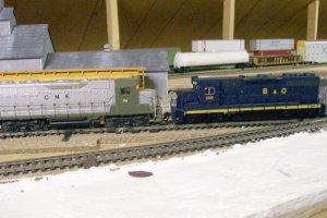

You peaked my curiosity.
So I went and looked for my self.
I have both the older Athearn GP-35, and the newer one released a couple of years ago. At a distance, the height is barely noticeable.

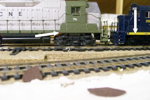

But after looking closely, I did notice that the older GP35, sat higher.
You can see that the bottom of the sill is much higher on the older Athearn than the newer one. This exposes some of the truck tower.

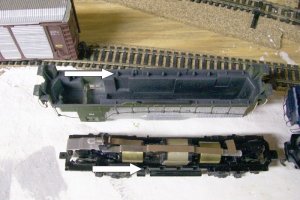

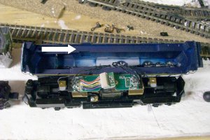

Taking the shells off, I think I found out what MIGHT be an easy fix.
You can see that these lugs, molded into the shell, slide into slots in the frame.
maybe, trimming these lugs a little will make the shell sit lower.
The newer shell, which is a modified RPP shell, dosen't have them.

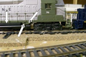

You'll have to work on the shell details a little.
First(#1), you'll have to grind back the locking lugs on both sides of the frame. Which means, you need a new way to secure the shell to the frame.
Second.(#2)You may need to trim off the "locking tab", and fabricate a new one without the hole.
And last(#3). Trim off the air tank. But this can be replaced with one from either Details West, or Details Associates.
