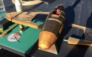

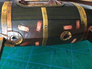

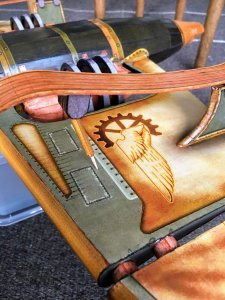

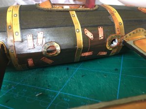

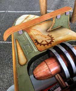

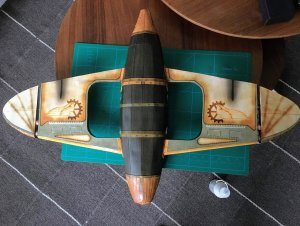

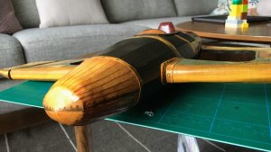

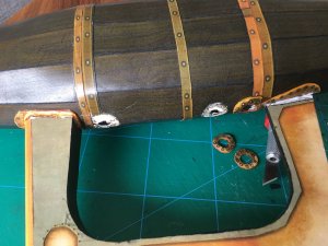

The wings are mounted. There was some missfitting and I had to reinforce the joints to get a good hold. I used spare parts ( the bands at the wingroots, last picture) to cover up the gaps that were reinforced.

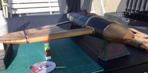

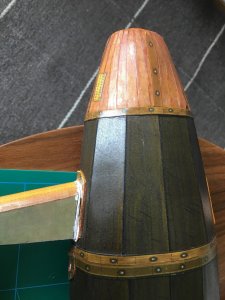

As I said before, the nosecone also had fittingproblems. I had to cut of some petals on the underside. I covered up the gap with a spare part ( the band,) You can also see the reinforment done on the wing.

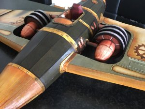

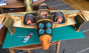

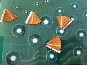

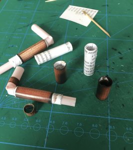

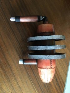

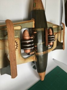

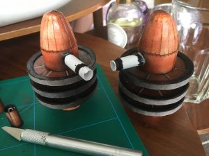

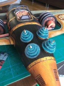

Some more engine-parts. I needed to strenghen the pipes that attache the engine to the body. I used rolled paper over a drinking-straw and then covered everything with the pipe-parts. I omitted the bends because they were to fiddely and teared easily
And here are the engines attached to the body

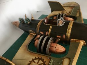

The tailplanes and windshield

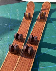

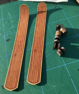

And the skids. I had to remake them because the sag. I laminated the skids with cardstock, total 3 mm. I made an extra leg in front of the skids, as you can see in the pictures
When I put the plane on the skids the body was to heavy and saged in the middle. So I made an extra skid.. thumbsup

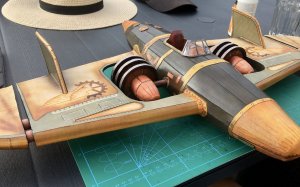

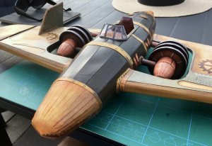

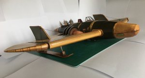

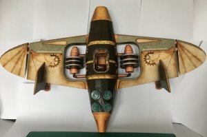

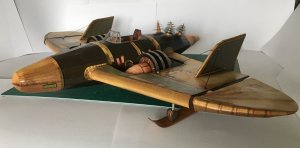

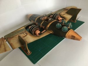

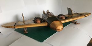

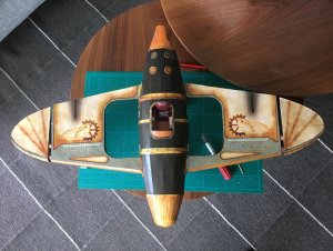

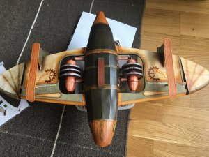

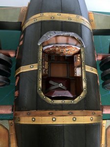

Here is the finished model.
Conclusion:
A model with a lot of missalignments, Not all parts fitted and needed corrected. It has no internal formers, that is a must for a model as big as this on, the wingspan is about 60 cm. But it is a nice model in the end. But you have to put at lot of work in to it. I use 3 copies of this model in the end :wink:. A word of advice: Dryfit the parts before glueing.
Now to the pictures:
IMG_3902.jpg IMG_3905.jpg IMG_3907.jpg IMG_3908.jpg IMG_3909.jpg IMG_3911.jpg IMG_3916.jpg

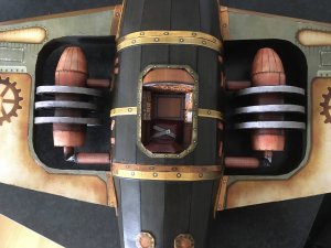

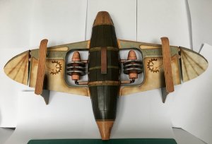

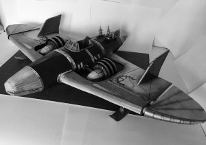

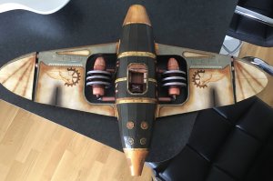

From above and the underside:
A black and white one...
Thank you for the encouring word and that you had the patients to follow this thread.
On to the next model....
/ Wilhelm
