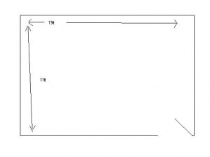

im hoping to start my very first layout it will be in ho scale my room is 15 ft by 11ft with the door in the corner so i want to go around the outside of the wall layout with open space for the door

ok ill try and post a plan of room its empty room in basement

ok thanks for the rapid replys guys ok the dorr is 32 inches wide and its 3 inches from the corner
im thinking about goin all around the 4 walls but leaving the gap for the door unless thats a bad idea i know this will be a long term project kepp us busy for a few years lol

What equipment do you expect to run? What time period is this going to be set in? What sorts of operation do you want? When I design a layout, I like to have an idea of its function.

Modern - not a space saver. You'll need broad curves, say 30" radius, even for freight. The huge end loops you'll require will force the layout well away from the corner. It'll be more like an L along the left and top walls, with big "blobs" of benchwork in the corners that would need access holes because of their depth. Modern railroading in HO on a 15x11 L is going to be very cramped. Based on John Armstrong's principle of "square squares", (quick explanation: a square can hold a 90-degree double-track curve of your minimum mainline radius) accepting a duckunder, such as a bridge across the entrance, would effectively double your available space. :eek: :eek:

Not too long ago, I helped someone with a 9x15 HO layout that had to offer mainline running of big equipment. That plan relied heavily on double-decking. For anyone else, that's what I'd suggest: the L on the lower deck and a duckunder bridge on the upper. However, you have a special consideration that will prevent that: expecting children to be able to view and operate. Double-decking usually requires keeping the upper-deck track about 5 feet off the floor so the lower deck isn't too low.
Your plan seems ambitious for a first layout. :cool:
