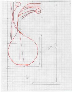

Ok,
Here's something I doodled for you...I know it's a little rough, but maybe it will give you some ideas.
I was working under the assumption that your room size was 10x6, so the actual layout is only 4x8, with some walk-in access.
Minimum radius is 22", & since you said you liked point-to-point, that's what it is, crossing over itself at about a 60 degree crossing.
Turnouts would be #4 (not to scale)
Turntables are very small...about 9"...but by rearranging some track, you could probably make them 12"
This is a completely level track plan...(just like Kansas! ;) )

scoobyloven
Jan 13, 2002
308
zeeland michigan
thanks for the plan but can we put in a loop at both ends for a larger main line and put the turn tables at each end.... i was talking to my father today and he would like one turn table at one end.. and one at the other or a siding for a run around to get the locomotive aroud the cars he wan't point to point and some switching to and some branch lines here and there you got the room size right it's more like 10 x 10 but their is a closet in the room so the space is 10 x 6 and he would like it to be in a ( L ) shape 10 feet X 6 feet so if their is more you need email me at scoobyloven01@yahoo.com and i'll be happy to get more info for you ....
