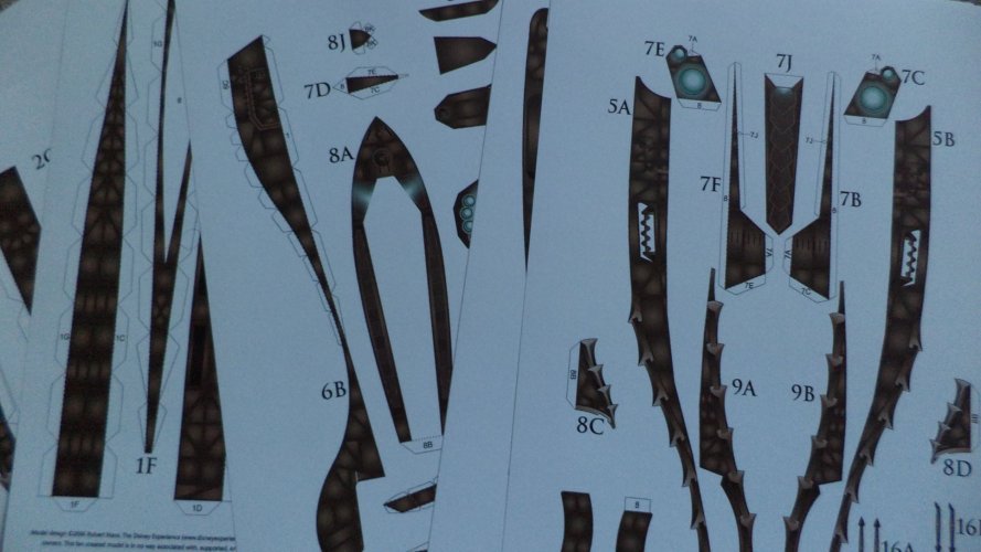

Around 78 parts make up the model, and as custom on my builds of late, I had my local copy shop, enlarge this up onto A3 sheets.
Giddy with excitement and rubbing my hands with glee... *I set sail to own my Nautilus - *Come with me as I dive in!
(*This build will no doubt be full of nautical puns)
Sorry for the low light on these first two shots, as I was away from the bench, due to technical reasons.
78 parts on seven sheets are the order of the day here, with a further 9 making up the stand (sheet not in picture)
Parts have good register and offer a nice rendition of the boat.
Stand assembly is the first order of the day...there's no instructions for this, but I'm happy it will become apparent when pieces are built.
