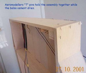

For this purpose I have found balsa an innovative, light weight alternative to traditional, heavier benchwork materials. See photos of my modules on my website at http://users.bigpond.net.au/miller_site/Gavin_index.html .
I can construct a balsa module in just a few hours using nothing but an exacto knife, balsa cement and "T" pins! Carving contours in balsa benchwork is also a snap. Balsa frame shapes for hills can be added on top by simply glueing and pinning.

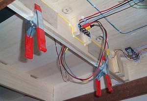

To answer your question regarding joining balsa modules together, I simply use spring clamps. To avoid crushing the balsa I have glued small squares of harder MDF at the mating surfaces. My modules can be disconnected and disassembled even faster than with "C" clamps - no winding involved!
I'll attach a photo of the underside.

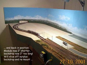

Just quickly, before I disappear again, back in 2001 when I shifted house I discovered that the combined length of my modules was just 4 inches too long for my new layout room.
I used my exacto knife to cut 4 inches off my "end" (turning) module, then glued it's end back on. Within 30 minutes, after the glue had dried, it was back in the layout. Here's some photos to illustrate.

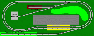

ok folks, I've decided to build a two module door layout.
I'm going ot build a freelanced railroad, with my own railroad name (yes it means painting )
planned:
A double loop layout, with the possibility to run two trains at the same time, or having one runing and doing some operation inside.
Overhead wires (I want to have some passanger trains, specially based on European Trains. TGV! TGV! TGV! ICE! ICE! ICE!), a small town, two or three industries, a two track loco shed and a passenger train terminal.
But I've seen the link Errol posted, but those are kinda hard to brake in two parts... I think. any way there isnt one that satifies my...
Do you know any more sites that have layout plans with this size?
Thanks!!! I'm still a newbie compared to you guys, but I keep learning.
this was the plan I came up with... but I think it's kinda empty....
what do you think?
