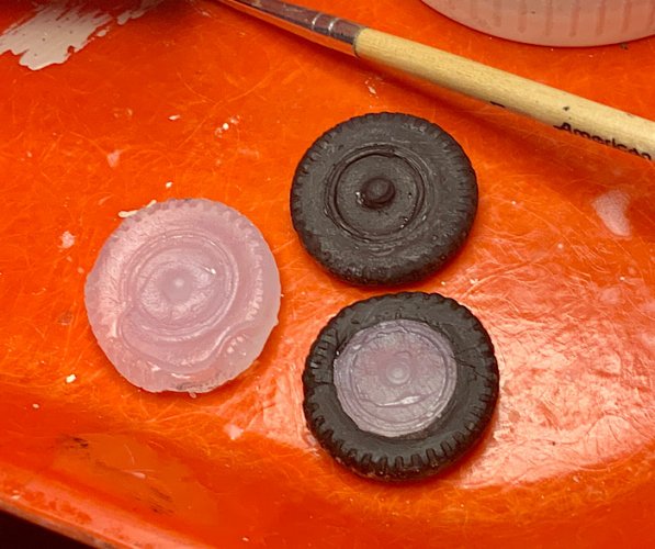

I’ve started messing with ordinary air dry clay for the mold. I saw a guy make a part with the clay and hot glue on youtube and tried it. It works, although it is a bit fiddly. My first wheel came out OK, the third one was fubared (but still useable) by a glue gun burp and the second one is ugly, but still can be used.
Those are about 1” in diameter, or 35 inches or so to scale. The all black is the first one, the black tire is #3 and the glue one is #2.

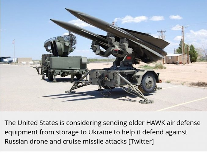

The real Hawk setup looks like this:

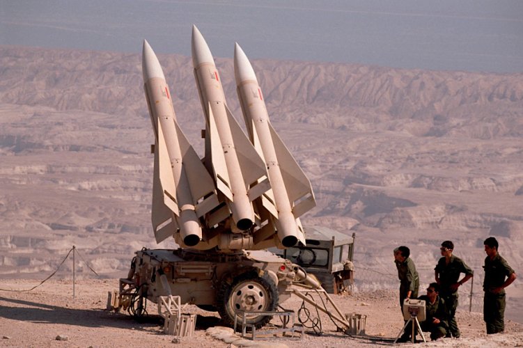

I have the 3 missiles, tan like these, and the mount. I will need to build the trailer.

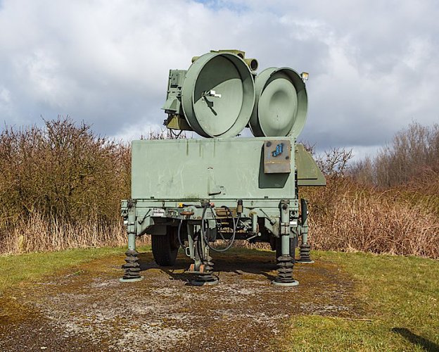

And the aiming/radar unit for this looks like this. It will have to be entirely scratch built. I think the bottoms of two soda cans will be perfect for forming the radar reflectors themselves.

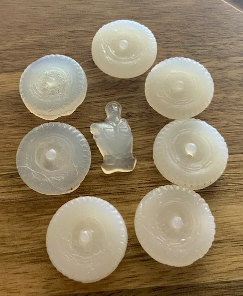

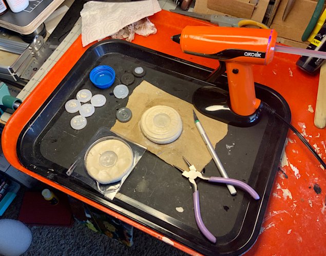

I set up two wads of clay, one in a plastic form just for fun and started making wheels. I oiled the surface of the clay and the pattern wheel. Then the pattern was pressed into the clay and the mold manipulated until the wheel looked OK. I removed the pattern with a tiny pliers. Each mold was pumped full of hot glue, allowed to cool and removed by sticking the xacto knife in the back and pulling. Then I pressed the pattern in the hole again and repeated. Now I have a total of 10 wheels to play with.
I also cast one of the amputees from my army man limb transplants. I pushed him into the clay and cast a copy. That worked fine too. Now I need to remember to copy any cool greeblies I find. This only takes a few minutes to make multiples of anything small like that.
The assembly line:
And the results:
Those wheels aren’t perfect but it doesn’t matter. It is a WAR zone after all. :biggrin:
Those wheels could become part of a model or a junk pile or a spare on some equipment.
