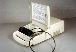

looking for a compressor, but havent been able to find it anywhere
ding chavez
Jan 17, 2006
33
43
Philadelphia, Pa
It's called the AutoMist 2000, and it's mentioned as being very good in this airbrushing book I'm reading. The only thing is, I try to go to the site of the manufacturer mentioned in the book, www.automist2000.com, and it no longer exists. I also could find nothing about it on Ebay, and searching for it on Google didnt bring up many helpful results, besides linking to the website which no longer exists. So, does anyone have one of these or know where to get one, or what happened to the company?
The book I'm reading was published in 2001, btw.
(Here's a picture of it I found online.)
