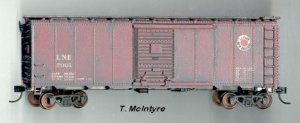

Here is the LNE Boxcar that I had the trouble with decaling. The car is more heavily weathered than others I have done recently because I figure that it is supposed to be about 35 years old on a railroad that is going out of business.
Road: LNE
Kit: Atheran Wood Boxcar - Undecorated
Paint: Folk Art Barnyard Red
Decals: Walthers
Weathering Rust: Burnt Sienna Acrylic by Daler-Rowney (tube) mixed with rubbing alcohol (Does not show well in photo)
Weathering Dry Brush: Polly Scale Grimy Black
Weathering Wash: Polly Scale Grimy Black
Wheels: Polly Scale Rust
Trucks: Polly Scale Grimy Black, drybrushed with Polly Scale Rust
Sealer: Testors Dullcoat

Rookie question - how do you detail the wheels. Do you remove them from the carbody? What techique do you use to apply the "rust"?
I have not progressed that far and have only looked at the car itself and have not considered doing wheels.
