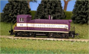

What is the difference between the SW8, & the SW9/1200? Could you post a picture?

Nice SW8. Is that standard paint or did you custom paint? Nice SW8. When I return from Chicago, I will get my decals on my custom SW1200. Nice SW8. I am still going to put a Lenz Mini Gold decoder in my SW1200. Nice SW8. Then I will post a photo of my SW1200.
Oh! Did I say Nice SW8? Enjoy your investment. :wave:

That's a stock photo from LL. They offered 2 road numbers in SAL and I think both are still available.
