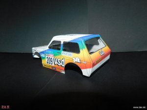

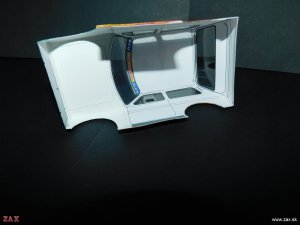

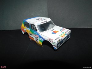

Since we are running the Dakar again, I got a taste for a car from this rally. I'm trying to glue Niva, which can be downloaded from Spidy. So far, I have a glued bodywork. The first time I used double-sided tape on glass and I must say that it is done much better than with second glue, I recommend.

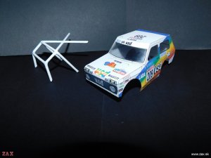

I didn't find anything very suitable for the frame, so I finally put it in a kick from an ordinary skewer ... I don't edit it much, I just added a sliding window to the right side. Now the interior awaits me ...

I've always hoped someone would build this car. You achieved excellent results on the windows. I would have gone a different route, but my way would not have looked as good as yours. If you could explain how you did that, I would be most appreciative. That glass looks excellent!! :)

Just wondering - what material did you use for the windows? Was it transparent plastic from a clear plastic bottle?

No, it 's not from the bottle ... you can buy A4 foil to Overhead projector, sometimes such films can be found when buying some goods, this foil is something similar ;)
Wow!:surprise: I never would have thought of that in a millions years!:toast: Great tip! Thanks!:)

I thought that this is generally known, it is often used in our country, it is cheap and can be easily obtained ... ;)
I would also mention that I used to glue it with gel second glue, but it was a problem to keep the glass clean during gluing, so I tried double-sided tape and the glass holds well without the problem of contaminating the glass ;)
